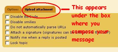

There should be no problem using the "Upload Attachment" tab at the bottom, providing the file is not too large -- say 600 x 700, and is saved in the standard JPG image format on your PC.
1 -- Click on "Upload Attachment" tab,
2 -- Click on Browse (You'll see a pop-up screen showing your PC's files)
3 -- Locate and Click on the folder that the file is stored in
4 -- Click on the file to highlight it
5 -- Click on the OPEN button (The pop-up screen will then disappear.)
6 -- Click on the "Add the File" button
7 -- On the next screen that appears, click on the "Place Inline" button
8 -- Click on the Preview or Submit Button.
I've attached the following using the above method as a test, to make sure it's working:
