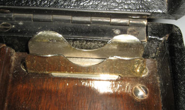

I'll go and ask on the other forum as you suggested. I have one other thing that I'd like to know. The bracket behind the tone arm? What is it for? The soundbox? I'll attach a picture to clarify what I mean.

the 101 is my favourite portable although the soundbox problems have always put me off the late ones. Soundbox gaskets are largely preferance,trial & error for accoustic performance, & what you find aesthetically acceptable. They are easily changed so will not affect value of the machine. I have found the purpose made no.4 gaskets to be satisfactory & easy to fit. Silicon gasket material is quite cheap so if you decide to use it why not buy a decent length & save it for the next machine. If you find a source of rubber inserts for the neck of a no.4 please put the address on the forum.

that clip is for a tungstyle tin, tungstyles were very hard multiple use needles. The gap should be quite narrow & I think yours has been opened up by someone forcing in a normal needle tin, this commonly happens & is easily reversed.

listner wrote:Hi, that clip is for a tungstyle tin, tungstyles were very hard multiple use needles. The gap should be quite narrow & I think yours has been opened up by someone forcing in a normal needle tin, this commonly happens & is easily reversed.

It appears the question about the plated clip has been answered by listner; it IS indeed for a Tungstyle (or Tungstone in the US) needle tin.
