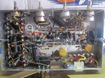

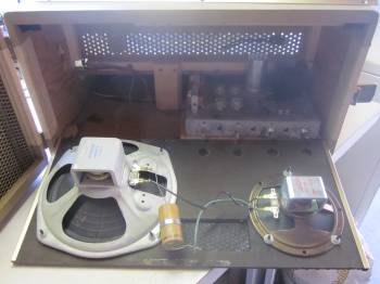

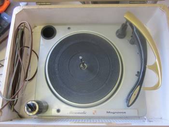

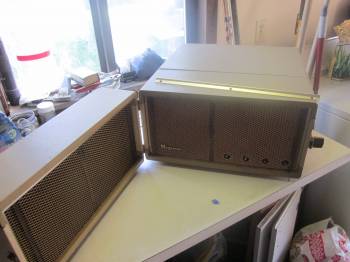

by KD7CNH » Fri Mar 09, 2012 4:28 am
Thought I'd post a couple of before pictures of my project.
Will probably be a few weeks before I get a chance to start the cap job and further test.
I'll post a couple pictures after the repairs.

Re: Magnavox Suitcase Phonograph Questions
by MattTech » Fri Mar 09, 2012 5:53 am
I see about ten capacitors under that chassis that I'd rip out and replace.
All those black cylindrical ones.
And..... that main multi filter topside (shown under chassis in the square cutout)
