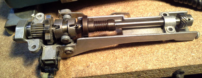

I'm applying the best of my general experience in this and hope to get some suggestions. I figured out how to remove the clutch. Geeze what a sloppy dirty mess. I let the whole assembly soak for a number of hours in solvent which cleaned most of it. I used an old toothbrush for the rest. I worked the clutch slide back and forth a zillion times in the solvent and I believe I got out all the sticky gunk.
You can see it came pretty clean:

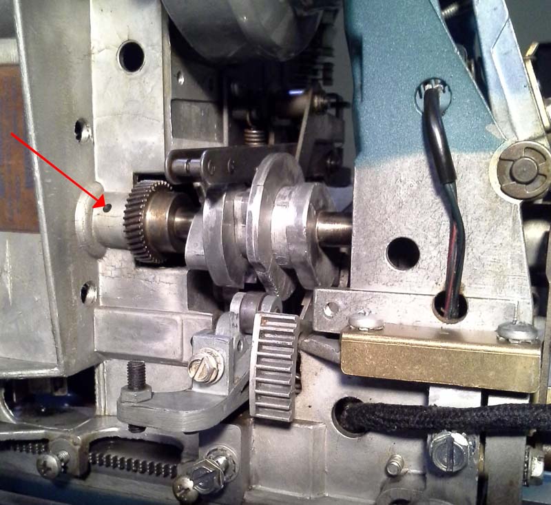

I spent the day cleaning the rear of the mechanism. I found that I can squirt a bit of WD40 on my rag covered finger and it cuts through and removes the old dried oil and dirt from parts. You can see in the photo that I got it pretty clean. I have a question about oil if you don't mind. One oiling point in the manual says "CAM SHAFT BEARING.. FILL OIL HOLE". The arrow in the manual points to a vague area. If you look at my mechanism photo I've put a red arrow. Is this the hole I need to fill with oil?

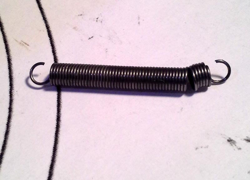

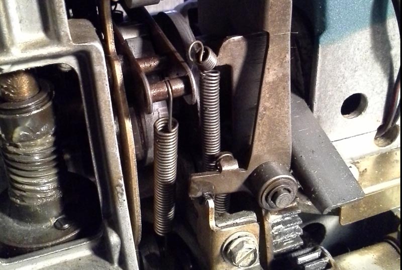

Another thing is this boogered up spring. I think it was probably someone's "fix" for a dirty gummed up and sticking clutch. Gawd I hate when they do those kinds of things because I don't have another spring like it. I have a couple choices. I tried to straighten it out best I can, but you can see on the paper that it is still bent. I can either put it on bent like that, or put it on again the way I found it... except I'd cut the excessive pig tail off.
What would you do?

Steve, if I may say-so your cleaning efforts are excellent, but removing the clutch is not generally necessary unless the mech is bucking or sits and spins without completing a changing cycle. You will now need to do a full four step clutch setup. NBD.
"Clunking" noises from the clutch can usually be fixed with a minor touch-up of the clutch adjustments.

Try placing the spring back as it should be using the original loop. If the associated bearings are well lubricated the spring will likely work. If not you can remove a couple of turns and form a new loop OR bug Ron to sell you a new one.
On a newly washed mech I'll use that oil hole, but once in service I oil the camshaft bearing from the shaft end next to the motor and a drop or two next to the clutch gear. Oil works it way in.

Yes--that's the "oil hole" for the cam--but don't forget the other end, next to the brake cam--no "hole" there, just squirt oil on it--When oiling the cam shaft on the oil hole end, from the outside--wipe any excess off, or it WILL get onto the detent switch ( which does cause "problems")!
As for the "shortened spring"--As far as I know, in all the years Seeburg made that basic mechanism, they used very high quality springs, that really do NOT "fail". One exception, that I am aware of was the last production run of the SS-160, and the first production run of the LS-1. Somehow, during this time, a "new bean counter", was hired. This person either changed the spec. on the spring used to lift the clutch, or purchased it from an alternate source. This spring quickly "stretched" in normal use. They re-called and replaced it at no charge--This person also did the same thing with the cam shaft gear--this resulted in me having to change "hundreds" of them (OK--I'm "embellishing"-a little). As far as I know, this person only "won" one "war", in the short time he was employed--he eliminated most of the paint on the mechanism--
Anyway--my point is, unless "overstretched" Seeburg springs will last "forever". Should one feel the need to "shorten them", it is probably due to a "lubrication problem", and IMHO, a very short term cure. I would attempt to "un-boogger", and re-use that spring--without cutting it --if that won't work, it should be replaced. Be SURE the roller it works with is turning !!

I got the clutch back in and did the 4 adjustments according to the manual and it seems to be working perfectly through the scan and play modes by rotating the motor shaft. I put the bent spring back in as it should originally go.

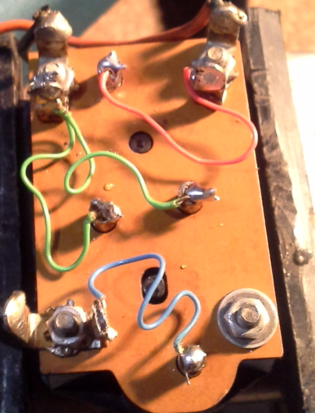

Another thing on my "to do" list was to properly fix the plunger block. The original wires were broken or missing and I temporarily soldered some #28 gauge wires a few months ago. They were really too thick and I was concerned they may inhibit free plunger movement. Today I got some thin wire out of an old junk phono tonearm as they more closely resemble what I originally found. I cut them a little long and put a few stress relieving bends so the movement won't break them as easily.
These are low voltage wires in a high voltage circuit and I hope the insulation is good enough. Anyway I tried to space them to prevent arching between them. I think that may be good enough.

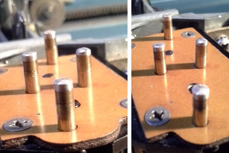

I had also previously thought the plunger silver tips were gone/wore out. On 2nd inspection they look pretty good to me. The camera wanted to focus on the front or the rear hence two photos. I might eliminate the two center plungers and ground the tormat's center grounding strip through a fuse. I could keep the two plungers as spares.
What do you think about the plunger tip conditions? (I'm not sure what they originally should look like)

Steve, the plungers look good -better than most of what I have in service.
When replacing the wires I use the ultra-flexible wire used to connect a speaker voice coil to the solder terminals. I've yet to have one fail.
When I used wire similar to what you have, I used a solder vac to clear out the plunger bottom. Then you'll see a hole through the plunger. I fed the insulated section of the wire through that hole then loop it around and tack solder it to the bottom of the plunger. The hole acts as a sort of strain relief.

The pins look great !--I use a burnishing tool on them to "slightly dome them"--but you should be just fine as is.
