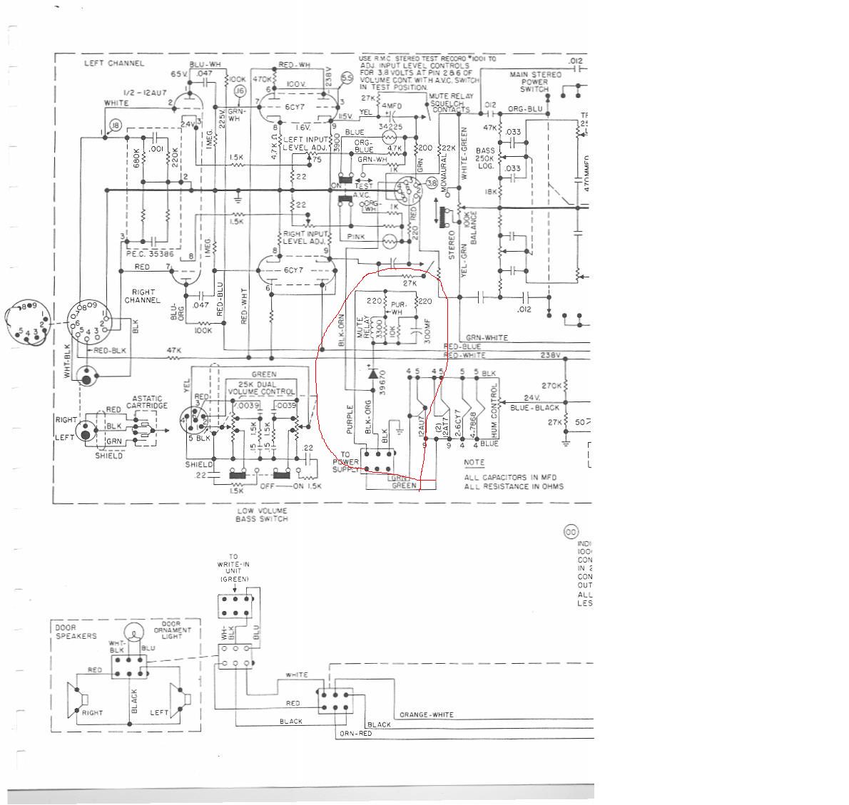

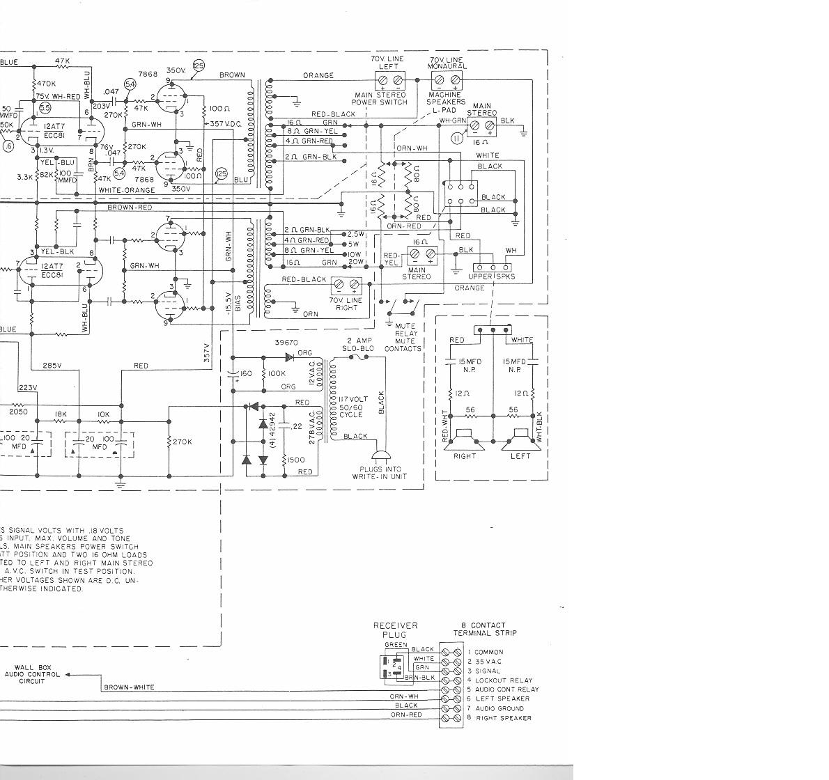

the two wires that will cause the relay to energise, i have attached one half of the amp schematic with the area circled in red and the other half for reference, the purple and black/orange wires coming from the power supply eventually form the starting point to energise the relay. I have replaced the 300uf capacitor at the relay, not sure if i can upload photos but this would show what i am on about

(152.87 KiB) Not downloaded yet
(124.15 KiB) Not downloaded yet

From what I see--the wire going to the round socket, pin 5, up-top, second schematic, controls the relay-----is that diode good ??
Where does this plug go--to the mech ? If so, I would think it goes to a switch on the mech that connects to ground when relay should be energized ? Where does the square socket connect to on the power supply ? Ron Rich

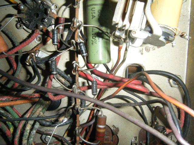

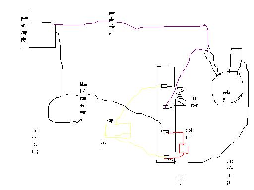

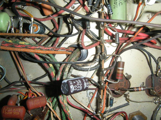

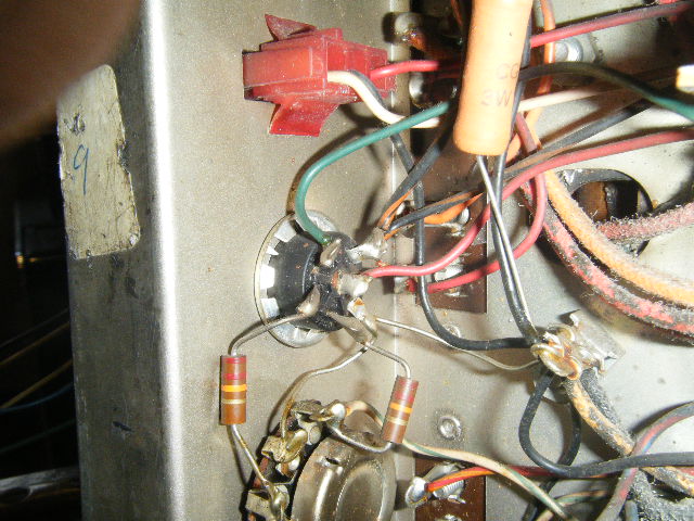

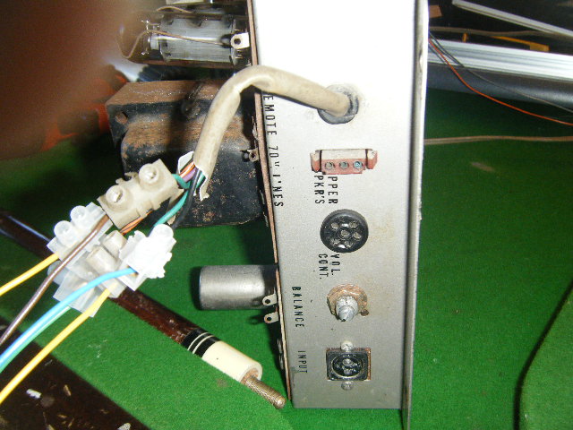

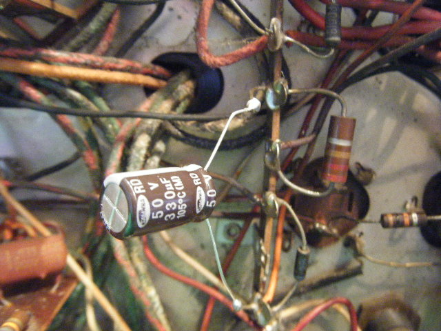

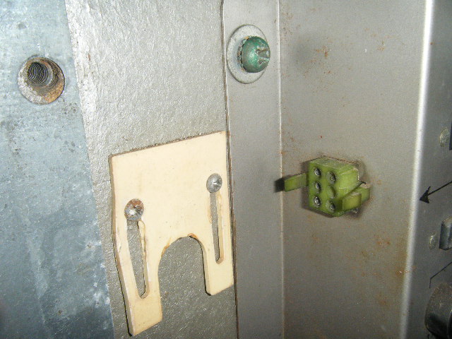

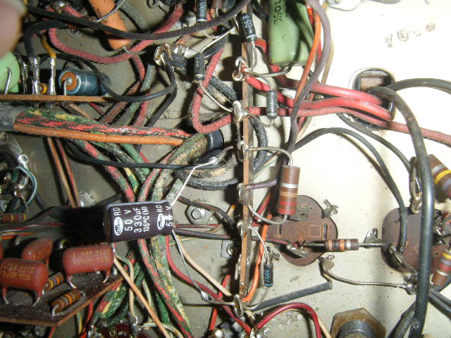

The round socket is where the volume control plugs in on the other side, i think the black/orange wire goes to pin 3 and it is spurred off down to the terminal post at the relay. There is no pin on the volume control connecting into pin three. The diode i measured in circuit and was fine, didn't measure it out of circuit. The square socket connects to the side of the power supply. I have attached some photos which show the socket, and general vicinity (terminal post) of the relay and also a very rough sketch. Two of the wires for the relay are disconnected as i was testing another one, the purple wire will appear faed in colour, the black orange wire beside the wire will appear orange (heat and time have faded the black
regards
clones
terminal post
Picture 218.jpg (119.39 KiB) Viewed 1267 times
terminal post
Picture 217.jpg (125.81 KiB) Viewed 1267 times
terminal post and relay
Picture 213.jpg (121.29 KiB) Viewed 1267 times
terminal post at relay
Picture 212.jpg (126.79 KiB) Viewed 1267 times
six pin socket
Picture 214.jpg (118.28 KiB) Viewed 1267 times
side of power supply
Picture 216.jpg (118.95 KiB) Viewed 1267 times
side of amp
Picture 215.jpg (116.59 KiB) Viewed 1267 times
sketch

try this then
-existing relay is back and connected in the amp
-in photo 215 there is a volume control socket (6 pins) photo 214, pin 3 on the volume cable(not in photo)
-black/orange wire from power supply unit goes to pin 3 inside the amp and from there is connected up to terminal at bottom photo 217. When i mean by terminal, its the one i highlighted in the earlier schematic. This black/orange wire is connected up to the diode and the + of the cap and then to the relay
-purple wire from power supply is wired also to both to this relay and this terminal (photo 217 located between the resistor legs)
so what i did....., i soldered wire to pin3 of volume control which now sits into pin 3 of the six pin socket and connected it up to black/orage wire that microswitch controls, this wire is looped onto the reject button and the gripper reverse relay socket of the control box.
