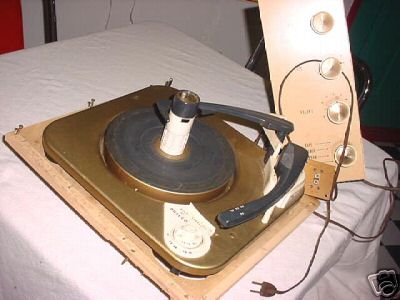

I've attached files on here by clicking the upload attachment tab at the bottom of the page when you reply. After that its just like attaching a file to an email. If its a webor changer it should resemble the one like i'm attaching here which is a Philco branded Webcor changer.
Philco Webcor.jpg (23.96 KiB) Viewed 1273 times

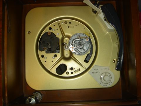

by JoeSeppRas » Sat Jan 03, 2009 5:00 am
To All,
I can see that it's a Webcor by that pic . Here is a photo.
Thanks, Joe

Several notes on that Webcor changer:
1. The center bearing of many Webcor turntables had a ball bearing with a Bakelite or fiber ball race. Those are easily broken in shipment. Then the pieces and balls escape the assembly and are lost. Now the turntable is too low, and is sitting on only the side plates. That makes noise. The later ones had a metal 3-ball race that could get damaged by crimping.
2. A Garrard center bearing also fits Webcor and Collaro turntables.
3. If the turntable is too low because the bearing broke, it scrapes on other parts. The needle also will not go down far enough to play the first record.
4. Note that a skating arm usually indicates that the stylus is broken off.
