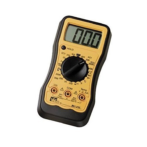

The switches continuity tested fine. Both old and new. So what do I need to set my multimeter on to be safe to test for power on the yellow black wire? I have an ideal 61-310?
I'm guessing right where it's at in the image at 200 ACV. Red lead in temp/v/mA and black lead in com.
Don't worry. I'll disconnect the leads from the switch before I test yellow black on 2a and red blue on 2. I got my wires crossed earlier.

Hi set the meter to DCV 200 for dc volts the voltage you will be looking for will be in the region of 25 to 30 volts dc, black lead to the com and red lead to the V Ohms and mA

I should have realized that it would be dc from working on computers, but my head is dead. Thanks for sorting that out for me. I'll test it out when I get home. Oh! And it says -33 VDC on the diagram. Doh!
