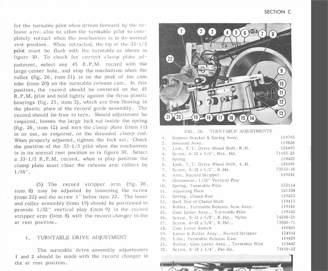

Here is a page of the manual talking about adjustments to the turntable..
I will try and understand what to do
Julie
Turntable adjustments.jpg (279.37 KiB) Viewed 345 times

Ron, the manual says to use the adjusting plate, which I did, many times, to finally have the record clamp... now I have to find a way so it clamps AND unclamps as it seems that the back end of the clamp shaft is the one to play with to release the record.... and the utility of the bolt just behind the adjusting plate is a bit confusing to me..
for now it is : when it clamps, does not unclamp and when it does not clamp, it unclamps perfectly :D gotta find the in between

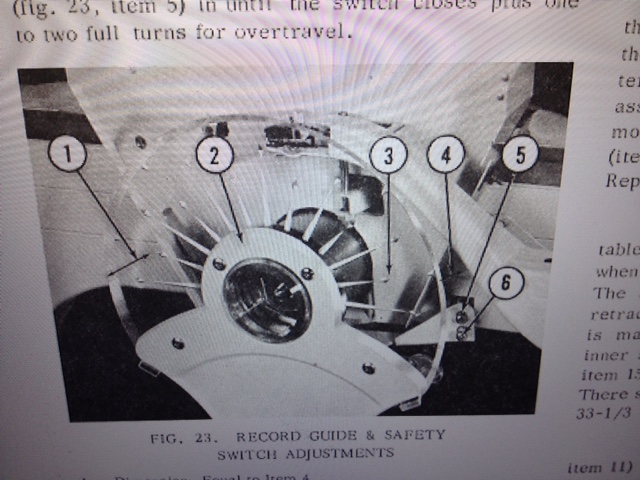

Rob-NYC wrote:Julie, the Cam Lever Switch looks bent out of shape. Those look to be normally closed unless opened by the lever. Do you have a contact bender (stupid question..I know..) Try carefully removing the switch so that you can bend the blades so that they will stay together except when opened by the screw on the lever.
I suspect that is the problem here. FWIW: I'd probably "lobotomize" the setup and eliminate the 33/small hole function if I were going to use it for revenue service.

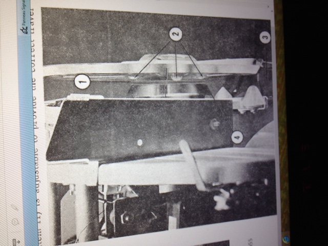

For now I am really trying to adjust the adjusting plate accordingly to the manual, but when the 33 pointer is flush with the sides of the turntable's front end, it does not clamp.. when it is outside of it, not flush, it clamps... but it does not release as the 33pointy thing keeps the record from falling off......
The anoying thing is, when I manually push the Record Guide's front casting...IT CLAMPS How in the world do I make the Record guide front casting closer to the front end of the TT.. ?? Is there a way to make it stay where you push it? See pictures attached for parts
Many thanks again!
Julie
adjustment from the manual flush
the space between seems larger on mine
what I need to push is Number 2
Re: A newbie's tale on trying to get a Wurlitzer 3310 to work...
by Rob-NYC » Wed Feb 10, 2016 5:40 am

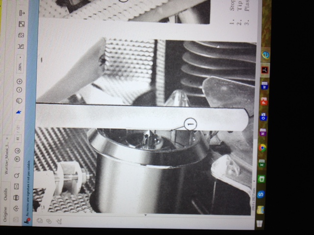

Hi Julie, the distance from the T-T to the stripper plate is specified in the service manual They are on Pg. 58 fig. 25. The dual speed mech's are a bit more critical than the older 45-only ones in that the pilot is shallower and flat because it acts as part of the turntable when a small hole record is clamped. The distance from the plastic bearings to the pilot is said to be approx ¼ in.
Does the stripper plate look like it has been bent outward? If not, it probably isn't the cause of the problem. If it is outside the spec and simple pressure doesn't bend it back it the mech has to come out and the top arch be removed.
When I have run into a sort of problem that defies quick observation, I slow things down by manually turning the changer motor shaft by hand.
Take a look at the operation of the record stripper arm (Pg 59 Fig 26 item 8) and see if it is timing properly. Try keeping it away during clamping.
You are in the right area.
------- :shock: From memory, I remember telling myself I thought the upper part of the front guide was bent forward, like in an angle.. I will measure it tonight....When you say:'' simple pressure doesn't bend it back it the mech has to come out and the top arch be removed.'' It is certainly not refering to simply removing the upper plastic part of the Record guide and trying to adjust right?? Should I start crying now? :)
--------------- Ok I will !

Rob-NYC wrote:Hi Julie, the distance from the T-T to the stripper plate is specified in the service manual They are on Pg. 58 fig. 25. The dual speed mech's are a bit more critical than the older 45-only ones in that the pilot is shallower and flat because it acts as part of the turntable when a small hole record is clamped. The distance from the plastic bearings to the pilot is said to be approx ¼ in.
Hi Rob
After further review, you are right, the record stripper plate is ok, not bent. So I gues not need to remove top arch :D thank god :D
I tried a small hole record, clamps and release perfectly...... It is almost annoying..... 45s large hole records still a no no
I will try and understand that record stripper's use and timming. The thing is that I do not know how it is suppose to work when / if its correct
I do not understand what it does exactly. I will read the manual, again. But this part is hard :)
ANd that switch, it says NO in the manual, but how can it ever close the way it is made? I dont get that either...
