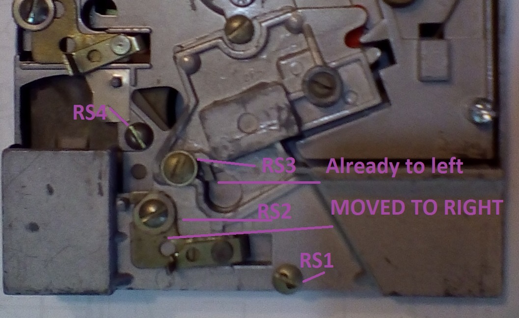

On the back side (the side with the paper sticker on it) --look at the bottom--count the screws from the bottom up--Do NOTHING with the bottom one (#1)--see screw 2 ? loosen it and run the "adjustable lever" as far to the right as possible, leaving just enough room for the flat portion to "swing". See the next screw up (#3), loosen it and push that anvil all the way to the left. That should do it as long as the rejector dime path is clean-- Ron Rich

Is the back the one with the small label at top, or two labels near bottom?
If you mean the small label at the top (81-16-344 01-74-02,
I have a picture with the labeled screws as I think you described. Did I get them correct
Dime still dropping through reject, may I need the VERY Hot Water Cleaning instead of the hottest water I can stand.
Re: National Rejectors Slug Rejector Help Needed
by Ron Rich » Fri Dec 04, 2015 5:55 am
What can I say--yep that's them--looks to me that the flipper at screw 2 is still all the way left ?? It also must be free to "flop"--

I didn't take a picture after I moved that lever.

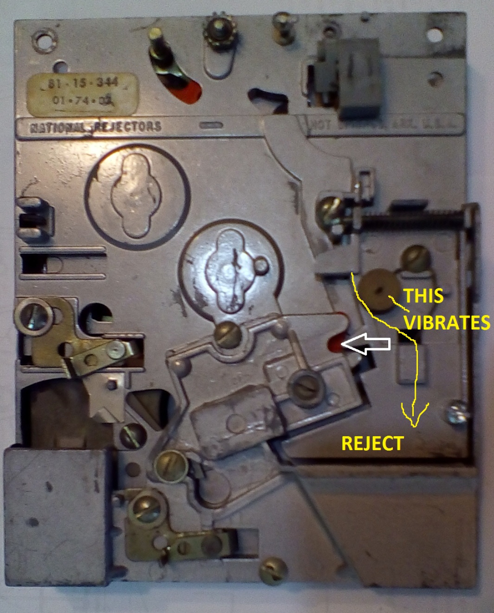

Do you mean the red plastic by the white arrow. The yellow line is the path I can see the dime drop to the rejects
https://www.dropbox.com/s/esyrusp4n7mt3 ... e.jpg?dl=0
https://www.dropbox.com/s/esyrusp4n7mt30q/RedDime.jpg?dl=0
(or maybe it will show up below)

CoinOpCollector wrote:Ken,
Do you know what model this is, where I can get manual?
Yes, the red plastic by the white arrow. If that cover assembly is removed, you should see a tiny red plastic part with a metal wire molded into it. That hits the serrations on the side of the coin to slow it down properly and feed it to the "accept" hole. One thing disturbs me though. In that same picture where you have a squiggly yellow line, There is a shiny screw on the far right that I don't think is supposed to be there. It looks like that screw is holding that spring loaded gate open enough to reject dimes.

I think that the screw (mentioned earlier), all the way over to the right, is the problem. It appears to be holding the gate open. That gate must be held against the main casting, or the "shelf" the dime rolls on will not catch it. I would remove that screw, check inside for "burrs", -----NOT "add a turn to the spring" -- and see what happens. (When you open the gate to check for burrs, you should see a slanted shelf that should catch, and funnel the dime to the left--to the anvil ). Ron Rich
