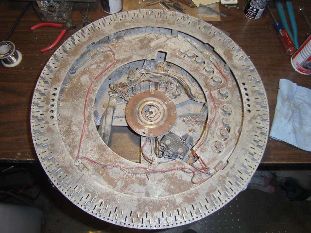

Thanks again guys for helping a rookie.The selector motor is the one that gets hot and hums after I select a letter/number, the number pin goes down and gives me 26 vts at the center of my start switch and when I trip it the truntable mech will start scaning(( not the selector). after reading the book it says the selector motor should run clockwise then move the triangle plate till it hits the start/reverse switches then reverse. It's almost like the motor is trying to run both ways at the same time or the motor don't have enough torque as everything seems to move freely.

Sorry Ron , it's the selector motor.Although all the selector mech components are moving freely the selector motor won't turn when the start switch is closed or open it just hums/hot I did notice the I have 26 volts on all 3 contacts on the start switch and the schematic shows it as a open/ closed with a common but will start the truntable unit when closed. Can I remove the selector unit at the bottom? I have a centering shaft to realign it .Looks like 2 screws and 2 allen head screws and plug everything in and operate it on the bench to isolate it from the truntable mech

Ron ,sorry for confusing, It is the selector motor that hums/hot .I just took the gear assembly apart and found a nut inside that holds the motor to the gear set.Woopie I thought I found the problem,thinking that maybe the torque of the motor was causing a twist and locking because of the nut.No such luck, so I jumpered 26 volt red to red and the 26 vol t to both black wires one at a time and the motor still hums etc. So I'm guessing the motor is bad?

Thanks for all the info, mine has a motor driven by 5 wires one connector has 3 wires red and 2 black, it also has a 2 pin connector that looks like it is a thermal or? The junction box is mounted on the bottom of the cabinet.Could someone at one point put another type of unit? Looking again at Junking motor it is for a 3000 but looks like thetype I would need. I'm stumped why the motor will not spin after taking off the gearbox when all the winding check ok as far as continuity unless the armature is bad

NAPA09 wrote:Thanks for all the info, mine has a motor driven by 5 wires one connector has 3 wires red and 2 black, it also has a 2 pin connector that looks like it is a thermal or? The junction box is mounted on the bottom of the cabinet.Could someone at one point put another type of unit? Looking again at Junking motor it is for a 3000 but looks like thetype I would need. I'm stumped why the motor will not spin after taking off the gearbox when all the winding check ok as far as continuity unless the armature is bad
Ok, if you have a motorized search unit. http://www.ebay.com/itm/Wurlitzer-Carou ... 1290078527 it is a 25 volt AC reversing motor. It must have a good phase shifting capacitor associated with it and all windings must be connected. I have a diagram for a 2200 (should be same motor) it shows a 75mfd cap.
When I get back later, I'll scan-post the schematic. There is a thermal cutout to protect the motor since it operates briefly in stall condition to index the plungers. If write-in fails due to poor relay contacts or a failed microswitch in the center of the pinbank, the motor remains stalled until power is cut.
On that type of search unit, http://www.southtexasantiqueelectronics.com/2310-31.JPG there is are two microswitches. You can see them near the lower right center. One reverses the motor after write-in and the other triggers the write-in sequence. Failure in the W-I switch will cause a stall.
I don't remember which of the two is the reversing sw, however in standby mode (powered but not selecting) pressing the actuator on the reversing switch will cause the search motor to reverse and run as long as you hold it in. Pressing the W-I switch will do nothing in standby.
