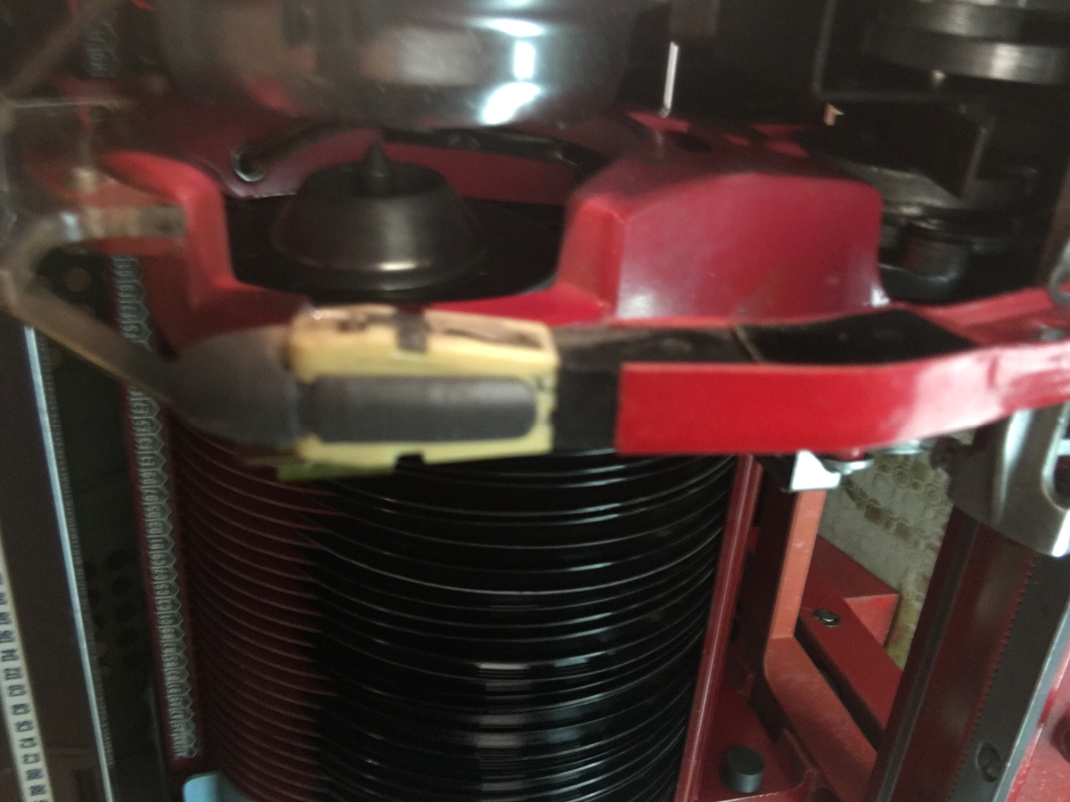

Post a pic of the cart on your machine.
I recently replaced the needles, but no change. Like I said before, it might be normal, just a little scratchy.
-Tony

Tony, that is one of the ceramic substitutes that op's installed decades ago to deal with the lack of stereo compatibility.
One of the VL's I bought in early 1989 came with the "Thorpe" version that used two somewhat better ceramics similar to what Magnavox used. It was still mediocre and "Victrola like". I removed right after the location opened, replaced it with a mono Redhead and in early 1990, installed an assembly from a later machine with a stereo cart that Seeburg used from 1966-on:
http://s1192.photobucket.com/user/Rob-N ... ort=2&o=69
There are no inexpensive solutions to improve the sound on these machines due to the specialized nature of the arm.
The simplest is to get a redhead and equip it with the newly made styli from Europe. This is a drop-in solution that will sound somewhat better, but a conversion to a later magnetic is the only way to get the best quality.
At this point the questions are; how deep (technically and financially) are you willing to get.
