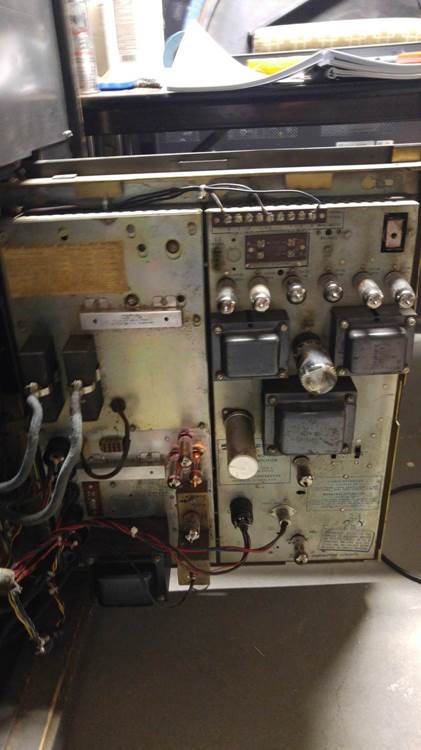

Hi all I have one last problem that I cannot figure out on my seeburg ds160, no selection with 8 will work all other selections work. Here are a few things I have done and I am not to sure where to go from here
1. Rebuild the TSU
2. I did the AA battery test to set all the toroid's selected and this worked, every selection played without a hitch (Perfect)
3. Clean the TES
I have tested continuity on the number selector and I am sure it is good, here is how I tested it. I got out my multimeter and set it to buzz, then I put one wire on the common wire on the number switches and then I put the other wire from the multimeter to the J551plug coming out of the TSU where the tormat would plug into then I press the number eight button the multimeter buzzes so I know I have a complete path?
Any help would be appreciated
