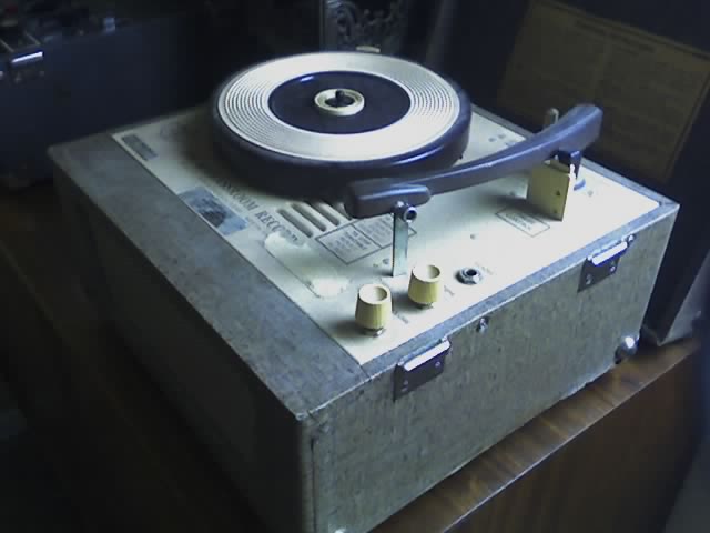

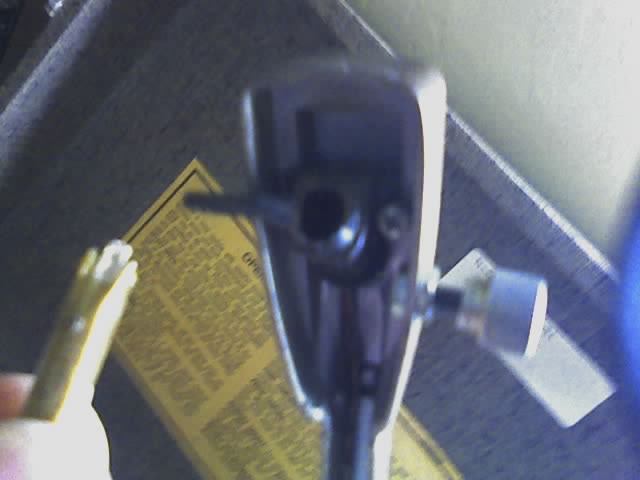

Plug-in Stylus & Cartridge.jpg (26.58 KiB) Viewed 2092 times
AudioTronics 300-E Classroom Recordplayer.jpg (29.76 KiB) Viewed 2092 times
