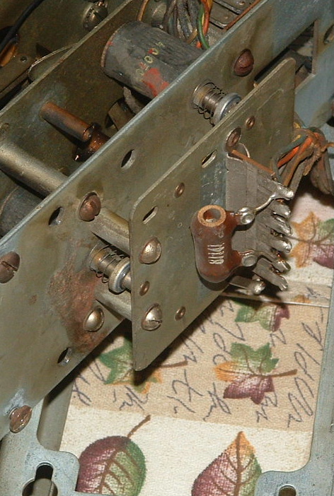

The fuse holder was weak I replaced that in the begining. I am electronicly Challanged (just learning caps etc.) the one ohm 5w.ww resistor you speak of is that the one soldered to the terminal strip that is mounted to the bottom on the CCU (picture 1)

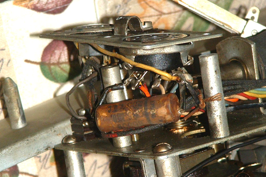

and should I replace the one that is briged between pin 2 and 7 (picture 2)

Yessir! You done did find it ! check it first--if bad, replace it--

I took the whole unit to a little electronic store I know. The guy has antique radio's all over the place. I picked up a cap to replace the one on pin's 2 and 7 on the socket. He also confirmed my findings on the resistor it test's at 1.5 so I am going to replace the cap also replacing the fuse with 1.6 SB, Cleaning all the switches again re-adjust them all and trying it one more time. Question, Is there a test for the pin bank coils or do they all have to be taken apart? If so is there any short cuts or is it going to be a long night.
