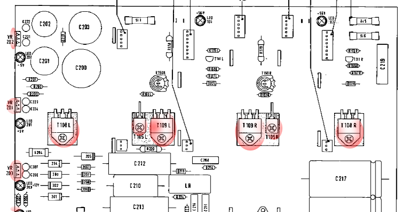

My question is, what Transistors are Grounded to the Heat-shield? Or are all the transistors isolated from grounded heat-sink (by the clear plastic things that sit between the thermal paste and the back of the transistors called 'Mica Sheet Insulators')

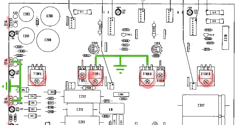

by NSMES160Jukebox » Sat Mar 12, 2016 10:40 am
Now... In answer to my own question :D
The both 'middle' pairs of transistors screwed vertically and horizontally to the heat-sink don't require Mica Sheet Insulators
only Heat sink compound is needed... However if unsure, a safe bet is to put Mica Sheet Insulators on all...
See Pic as reference....
