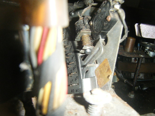

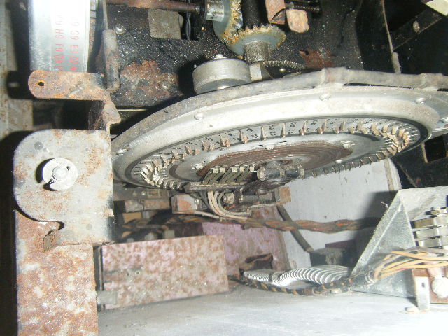

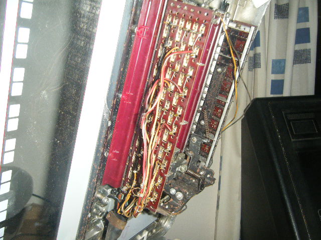

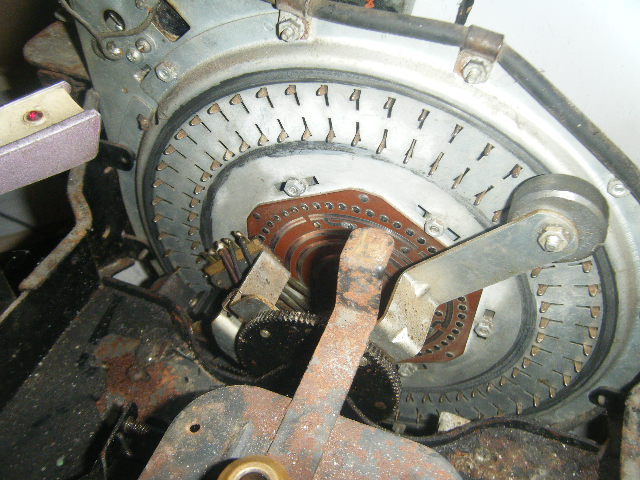

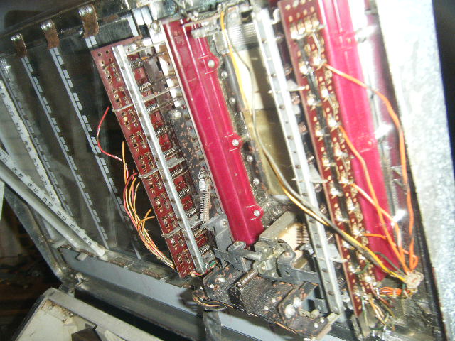

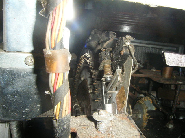

by clones » Thu Jul 18, 2013 2:25 am
Here are a few photos of the wobble plate and keyboard

It appears to methat the start coil area is awful dirty--plunger appears to be rusty--and I do not see the copper, U shaped "helper" spring-? See your parts book-- Ron Rich

I know what you mean about the helper spring but there doesn't seem to be the a place to attach it (hole for the screw and nut for attaching it) so i will have to improvise. However on checking the machine tonight there's an additional problem in that the write in motor is not starting when a selection is made, the write in relay is energising when a selection is made but the motor is not moving, so i will have to troubleshoot that first, it might be a coincidence but this latest problem started after i removed the part to clean the various relays and plug connections, will update if i make further progress

Perhaps that spring was not used on the small pinbank ??
