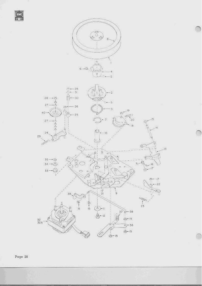

Thanks for the reply. I've taken a look at the base plate and also my service manual (see attached graphic of the turntable assembly). I'm pretty sure it's the Sensor Riveting Assembly that is pushed down on by the red tabs (the "Sensor and Pin Assembly"). Although it appears that the Lifter Bracket Riveting Assembly is also involved. If I push down hard enough on the red tabs (so that the 45 rpm record hub is beneath the turntable) the Lifter Bracket Riveting Assembly seems to lock into place; unfortunately the machine is not able to unlock the assembly by itself and the 45 rpm record hub remains beneath the turntable.
It's pretty hard to see what's going on with the turntable in place, and removing a record/selecting the slot doesn't really do anything to help determine what happens.
I'm really not sure what to remove, and I don't want to remove something that screws up the machine. If the attached graphics help to jog your memory, I'd appreciate any further assistance.

That's a horrible parts breakdown ! It appears that the long (bell crank) type item under items 17/21 should move somehow to push the (item 13) "lifter bracket --assemb." up--and should go down when the red fingers drop-- does that area move, or is it "frozen" ?? Lube it up, make sure nothing is "frozen" --problem has "gotta be" right there ! Ron Rich

Further to my last response and your most recent comments, I played around with parts 17/21 - that sliding thing with the long narrow slot. When the tone arm is engaged and the idler spins, I am able to push on the Sensor Riveting Assembly (22) which causes the sliding thing to move forward to the point where the Lifter Bracket Riveting Assembly (13) falls downward. Eureka! This is what causes the red fingers to drop. Unfortunately I have to do it by hand. The record alone will not cause it to happen.
Everything appears to be in place, as per the diagram. There are no add-ons or DIY contraptions present. But something does seem to be causing the resistance...I just can't figure it out. Everything appears to be well-lubed and there is no gunk.

Going off your diagram I took a look at
My model 414, looks to be same.
Remove lever #22
That part starts the whole ball rolling to
Change to 33 1/3.
George

A little more detail on my previous post.
With turntable off, start a selection without record
In slot. You should see (13) lifter bracket go down
And then back up after you reject. All this does is reset
Red turntable sensor, the sensor does not push it down.
Try a selection again,(no record, turntable removed),
As gripper arm is almost touching down, use the
Off/operate switch, clicking this off then on as operation
Starts, press (22) sensor riveting assembly with finger,you'll
See that there's a small window of time,(very quick)! Where
This catches in another slot. This starts everything changing
To 33 1/3. If it doesn't catch in that slot, so it can move slightly
The red sensor can't drop. Even when pushed!
It is the red turntable sensor that drops, moving part (22) that moves
Into the slot that causes the change of speed.
Hope that helps
George

Jeremy, the sliding slotted part should start
Sliding forward as gripper is almost on turntable,
Allowing part# (13) to automatically drop down.
It also has a little spring that helps push it down.
If not its not doing this, it has to be linkage underneath.
Part (13) has to drop down for everything else to
Take place.

Raven65 wrote:Remove lever #22
That part starts the whole ball rolling to change to 33 1/3.
I thought lever #22 was what caused the sliding slotted part to move. Does it just engage the change from 45 to 33 1/3 rpm? Will removing part #22 affect the sliding slotted part's movement? At this point, I have to forcefully push part #22 forward to cause the sliding slotted part to move forward and allow part #13 to drop down. The sliding slotted part does not move forward on it's own. I'm wondering if lever #22 is causing the resistance and whether removing it might fix the problem I'm having. But I don't want to remove it and screw something else up....
Raven65 wrote:With turntable off, start a selection without record In slot. You should see (13) lifter bracket go down and then back up after you reject. All this does is reset red turntable sensor, the sensor does not push it down.
Unfortunately part #13 does not move up or down when the record selection process is engaged/rejected. It should - if the sliding slotted part were able to move. When I do it by hand (push the sliding slotted part forward during the record selection process), the #13 lifter bracket does move down. When I move the tone arm (to reject the record), the sliding slotted part does move back, causing part #13 to move back up into position (and therefore, I assume, cause the red sensor to move back up in the turntable). So, on a positive note, something underneath the turntable mounting plate IS causing the sliding slotted part to move and enable the rejection process to cause the red turntable pins to move back up into position; unfortunately, the selection process is not doing what it's supposed to do.
Raven65 wrote:Try a selection again,(no record, turntable removed), as gripper arm is almost touching down, use the off/operate switch, clicking this off then on as operation starts, press (22) sensor riveting assembly with finger,you'll see that there's a small window of time,(very quick)! Where this catches in another slot. This starts everything changing to 33 1/3. If it doesn't catch in that slot, so it can move slightly the red sensor can't drop. Even when pushed!
It is the red turntable sensor that drops, moving part (22) that moves into the slot that causes the change of speed.
I've done this, and it works as you have said. I notice the idler moves up and changes speed (I assume drops to 33 1/3 rpms), so mechanically - this process is intact in my machine.
Raven65 wrote:Jeremy, the sliding slotted part should start sliding forward as gripper is almost on turntable, allowing part #(13) to automatically drop down. It also has a little spring that helps push it down. If not its not doing this, it has to be linkage underneath.
Part (13) has to drop down for everything else to take place.
As I noted above, the sliding slotted part does not move forward by itself; you note that it should start sliding forward as the gripper is almost on the table to allow part #13 to drop down. This does not happen on my machine. Something is creating a resistance; I thought it was part #22. Do you think removing part #22 (as you have suggested) might help this?
As I've noted, the record reject process does cause the sliding slotted part to move backwards and cause part #13 to move upward. So something under the turntable mounting plate is enabling this to occur. Could the same thing under the mounting plate be causing the resistance for the forward motion? Without removing the entire mounting plate, it's really hard to see underneath it and check out what is occuring.
