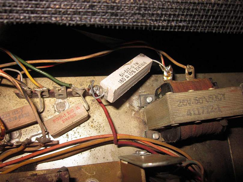

Here is what I see on my LS2 while referring to a LS1 TEC 1613-56 Schematic. Not saying this LS2 is correct – just how it is. Guessing the TEC on your SS160 is about the same as the LS1 / LS2.
Sidebar: Like you, when I obtained my LS2 has the latch solenoid always on and set to free play. However I CANNOT figure out how to revert it back and it is frustrating. Something in the UDPU6 was rigged but I cannot figure out what was altered. But I digress…
There are two 5 lug terminal strips next to each other on the left of the Latch Solenoid. One terminal strip in back and one terminal strip in front.
There is a 100 Ohm 10 Watt Ceramic Resistor (R3402) soldered to the far left lugs of both strips. The two wires coming from the Latch Solenoid (K3401) are also soldered on to these far left terminal strip lugs. Then there are wires from these two going off to plug terminals 2 and 8. So the 100 Ohm 10 W resistor appears to be in parallel with the Solenoid.

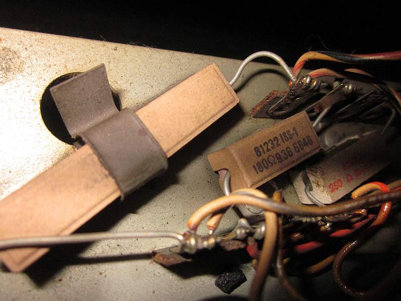

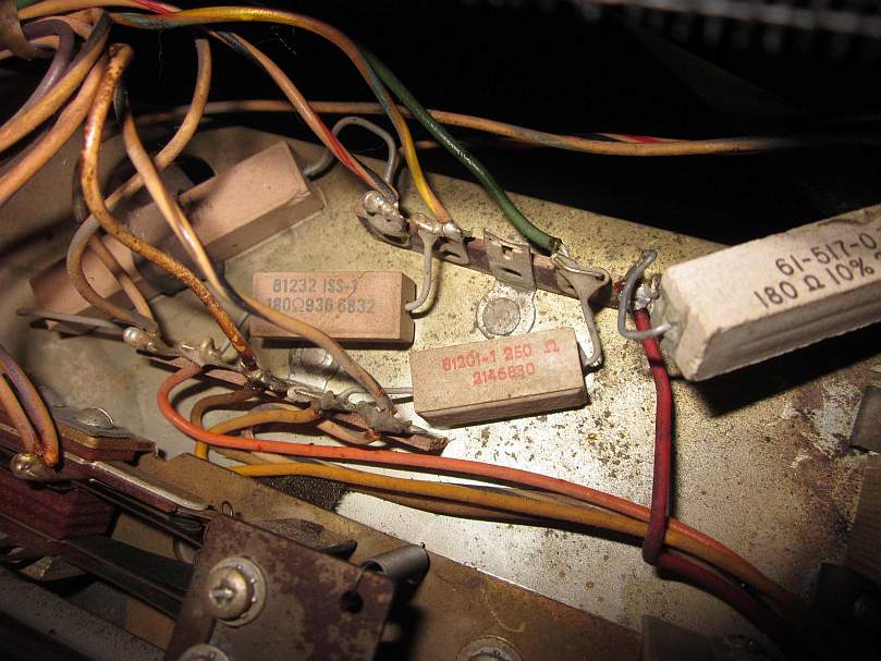

The next inner lugs on the left side have a 180 Ohm 5 Watt ceramic resistor soldered between the two strips with yellow/ blue wire coming and orange wire going. I believe this is R3403 and schematic says is to the Album Credit Light.
The middle lugs are riveted to the TES housing.
The next inner lugs on the right side have a 250 Ohm 5 Watt ceramic resistor soldered between the two strips with green wire coming and yellow wire going. I believe this is R3404 which the schematic says is for Steady Light (no clue what a steady light is).
TES Resistors A.jpg (75.45 KiB) Viewed 1062 times
The rightmost lug on the back terminal strip has a 180 Ohm 10 Watt Resistor (R3401) soldered to it and a red wire that goes off per schematic to the Singles Credit Light. The other end of the 180 Ohm resistor is soldered to the left post on the Latch Solenoid.
TES Resistors B.jpg (74.74 KiB) Viewed 1062 times
Interestingly the Schematic shows a fifth resistor, 65 Ohm (R3405) going to a Flasher but there is no resistor (and no clue what would flash).
