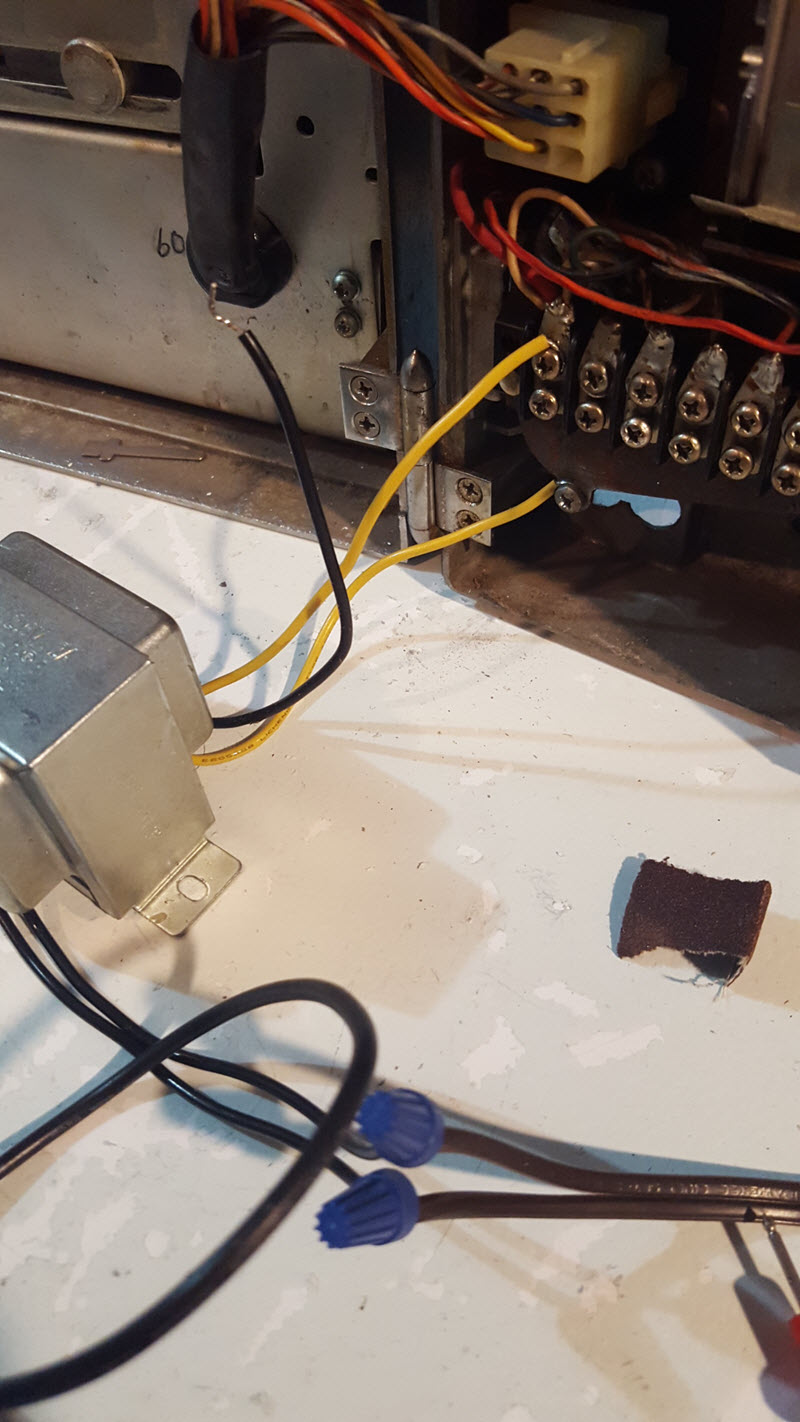

Ok. Got the transformer and think I set it up correct (see pic). Transformer is taking power on primary side, and putting out power on secondary side. I attached one of the yellow to far left contact, and second to ground. Nothing happened. But then again I have no light bulbs. Hoping its still a goer. Without lights to verify powered, should pushing the selector do something?

by Ron Rich » Sun Jan 17, 2016 6:26 am
1. Cut and insulate that black wire !
2.Check voltage on the two yellow wires--should be 25-30 VAC un-connected
3. If voltage is correct, check the Service Manual for the correct terminals to connect the source to--
4. If connected properly, establish credit ( remember--this machine like all "jukebox products" was designed to MAKE money !
5. You should no be able to "make selections" if your wall-box is operating correctly.

by DoghouseRiley » Sun Jan 17, 2016 1:50 pm
All you need to know, as I said, is on DataSync's website.
Download this PDF
http://www.cdadapter.com/download/wipod.pdf
The terminals from left to right are.
(1) 25v a/c ....(2) Signal line..... (3) Lock Out Relay.....(4) Audio Control Relay.....(5) Left Speaker....(6) .Audio Ground...(7) Right Speaker.
Below these
(8) Common (earth to chassis)
When you hook up the adapter, the connections are; Signal line and Common.

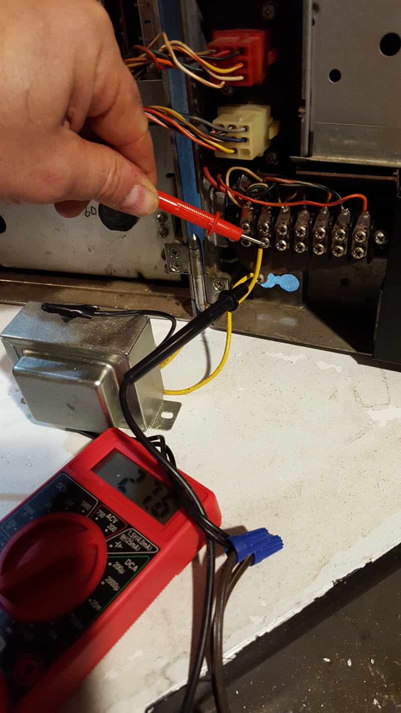

Ok, thanks everyone. Got it hooked up correctly I believe as per the instructions. Seems to be putting out the expected volt range (27.4) (see pic). Nothing obvious is happening but I have no bulbs. Would bulbs lighting be all I would expect with no main juke to feed it data? Bulbs ordered.

by DoghouseRiley » Mon Jan 18, 2016 8:49 pm
The bulbs I think are off a feed from the supply, 4, X 6v in series. They should have no affect on the mechanical function if they are missing.
You should be able to make a selection if you've now got power whether the bulbs work or not, if there's any credits on it.
Try a coin.

Re: Newbie with questions: Rock Ola 504 - where to start?
by clones » Tue Jan 19, 2016 12:04 am
Just clock up a few credits using the coin mech or the paddles below it and try a selection, although you wont know if its making the right selection until you have it hooked up with an ipod set up or a jukebox
by DoghouseRiley » Tue Jan 19, 2016 12:49 am
clones wrote:Hi
clones
Yes, that's the best idea as I said earlier. No point in buying the adapter until you can get the mechanics to work. You can hear and actually see the mechanism revolve after making a selection.
