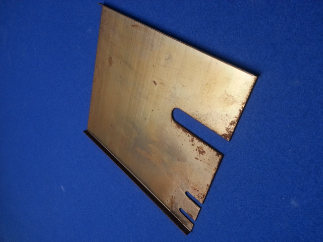

Here is the mirror that came with mine, I measured 6" wide by 7" tall.

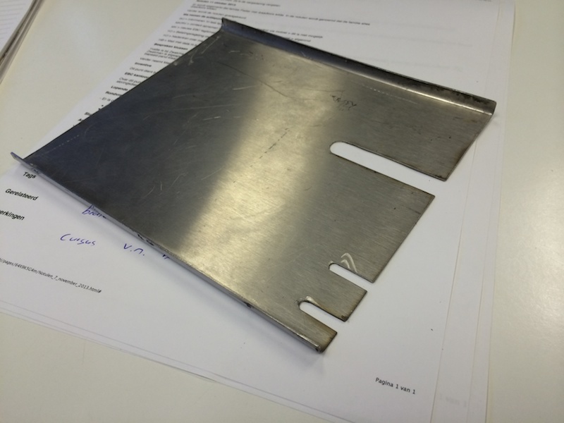

Do you also have a picture of the backside perhaps?

by james301 » Sat Jan 04, 2014 9:53 pm
Of course I do! Here it is.

Re: Req: Picture and dimensions of original Disco Mirror
by Ron Rich » Sat Jan 04, 2014 10:02 pm
Hi Guys,
I do not recall ever seeing one with that "sideways slash" in it, as shown on the first photo ?
The one I have here, is smooth on both sides. Ron Rich

by james301 » Sat Jan 04, 2014 10:16 pm
On the first photo it is reflecting the garage ceiling, it's smooth all the way across like you said.

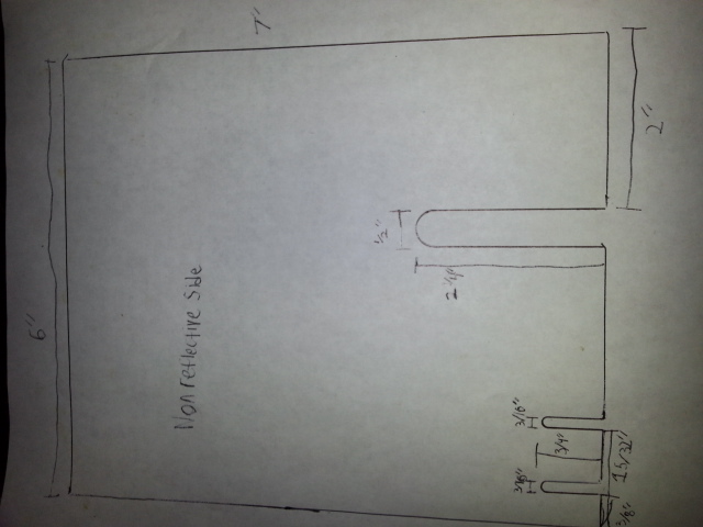

I hope you will forgive the fact it's a picture, as my scanner is being uncooperative today, but it should do. It is from the back (unreflective) side, and the distances are away from the closest side.

by MrMario64 » Sun Jan 05, 2014 4:15 am
This is perfect!
Thank you for all this information.

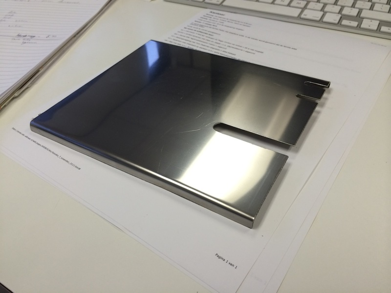

by MrMario64 » Thu Feb 06, 2014 11:16 pm
Well, today I made this mirror out of an old piece of stainless steel.
It turned out pretty awesome!
Only needs a little bit of extra polishing still
Thanks again for all the help!
