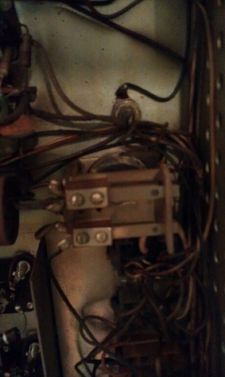

Hello,
I am beginning work on my childhood ls1, can't wait to get it up and running. I have just purchased the service manual and awaiting arrival, min of july 7.....but would like to reach out for help in the meantime on this pressing problem. I am electronically inclined, while not a jukebox service technician I know my way around electronics.
I've poured over all ls1 posts on this site and learned quite a bit about this machine already, but not my prob/solution. Here's the problem when a selection is made, after pressing the second selection button the buttons stay in ( which they shouldnt) and no response. When operating normally after pressing the second button they should pop out and trigger the carraige to scan to selection and loading of record.
Now the carriage will scan when the service switch is toggled along with the play/scan lever. Inside scc7, if I activate the module shown in the attached picture the carraige will pickup whatever record it is current in front of and play fine. I lnow this is dangerous and wrong however it tells me that the issue is between the selection and sending of the signal, and that carriage is not the issue.

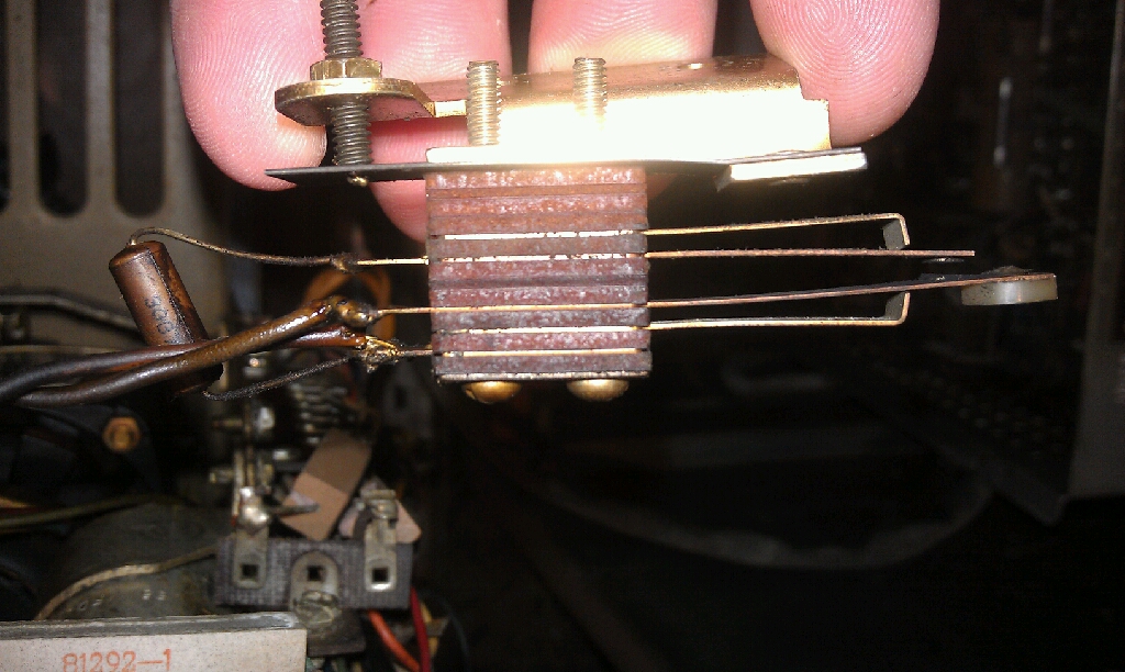

Ok problem solved. Selection is taking and begins scanning for record, however it never does stop on selection and play record it just continues to scan and scan and scan, no stopping. The detent switch which is pictured here is cleaned and all appears to be working correctly. The following are the voltage readouts on the scc7.
Detent switch open.

How are you "reading" the voltages--the read out voltage should be in the 300 volt DC range with the detent switch open--When scanning, with the service switch in play position, it should be half to 60 % of the "open" reading, BUT this reading may only be read with a good quality analog ( old styl) meter--Also, the contact points look dirty to me in that photo---

What I meant was the old fuse looked strange, I replaced per your instructions, all is well. The detent picture was before I cleaned contacts they are good now.

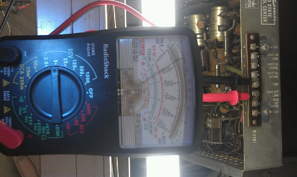

Attached is a picture of voltage on read out load when the service lever is in the play position. When moved to scan the voltage is 0. The detent is open, the contacts are not touching.
I appreciate your patience and assistance while we get to the bottom of this. Thank you Joe

Un plug the mech from the SCC and check the RO voltage.
Ron

I disconnected 13103 Mech, still same reading.
Re: Seeburg ls1 does not record selection
by Ron Rich » Tue Jun 19, 2012 12:08 am
Joe,
I dono what that number is--but dis-connected it should be about 300vdc--if all plugs are out, and it still won't read right, you have internal problems in the SCC-- ( What does the 150 vdc test point read ?) Ron Rich

Ok, believe my meter may have been faulty. Let's start over, I have a new meter.
Ok update on jukebox, now when selection is made it scans twice and stops. Previously it would scan endlessly.
mech plugged in service lever in the play position, detent contacts not touching, no selection made, carraige is idle. I am getting the following.
Read out is 1787 mv. If I make a selection and the carriage begins to move I get a read out measure of 1870 mv when carraiage is moving right to left. When carraige is moving left to right I get a read out measure of 320 mv.
With the mech removed service switch in play my read out measures 1844 mv.
With mech removed my 150 v measures 1873 mv with service switch in play.
With mech attached, selection made and carraige scanning my 150 v measures 1800 mv when going right to left when left to right it is measuring 830 mv.

Joe, what you are describing is a pretty routine case of current leakage in the following areas of the mech:
1) Detent switch. oil soaked switch that had become conductive. I've had this several times due to my over oiling and the motor slingling it onto the switch.
2) As above but on the reversing switch. This thankfully I have not had to deal with, but it can easily happen as the cable itself becomes "gummy" due to the oil in it's composition decomposing and leeching out.
3) Badly gunked plunger block (under Tormat).
Test: Connect either a neon test lamp, or a high impedance meter to the readout source (-150vdc) service switch in "play" and manually turn the motor shaft to get the mech moving. Does the voltage that is in the MV range ever go to full 150 on the meter? Or, if using the neon, does it light? Both should be happening when the detent sw is open.
If the voltage never rises to full; place strips of a business card between the contacts on the reversing sw that transfer the read out pulse from A to B sides. If voltage rises to 150 and stays, look for leakage on the detent sw. If not, then examine the reversing switch itself for heavy oil and gunk and then trace back to the tie point on the mach and back into the cable.

I located the reversing switch and luckily it does not appear over oiled. The detent switch is definetly moist with lubricant but not to the point where I would believe it would conduct inadvertently.
