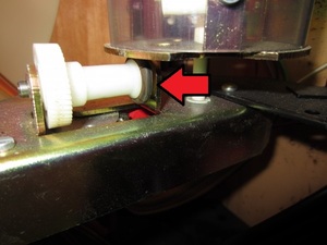

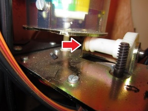

    - On the outside, the right front light doesn't "rotate" so it stays one color. Further inspection inside found a rotted grommet where the gear rotates the mechanism. Once replaced it will work fine. (parts dealers?)

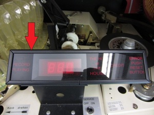

    - The display does not light up... at all (red LED numbers, etc). My guess is this either needs replacing or something is disconnected. It doesn't seem to be getting any power.

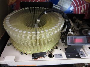

I've included pics of the unit so that you guys can see what I'm talking about:
Here's pic of the jukebox:

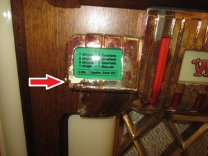

The plastic pieces are deteriorating (parts dealer?)

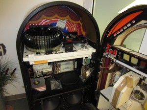

The inside: (Things looked very clean and fairly new looking)

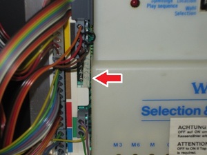

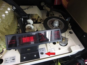

I'm assuming this switch is in the correct position?
This is the part that does not light up as it should. It's completely dead. My novice guess is that it's not getting power. Thoughts?
In this pic, the rubber grommet is missing which will allow the piece to turn (gives illusion of colors changing on outside)

On the other side, you can see the grommet in place. It works but it will need to be replaced due to the cracks.

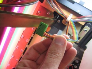

This connector is not plugged in. I'm assuming it's not supposed to be. But I'm not sure. This plug is located on the inside of the door.
This is a different connector that is also not plugged in. Again, I'm assuming it's not supposed to be. But I'm not sure. This plug is also located on the inside of the door.

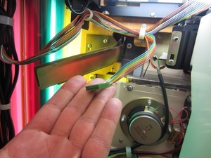

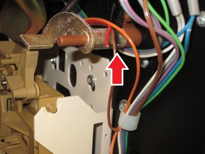

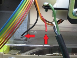

These red and black wires appear as if they were cut. Could it be that they were like this when the unit was functioning? Not sure. If they were cut, where would they connect to? My guess is one is ground and the other could be voltage. These wires are located on the inside of the door.
These are different red and black wires. These are located on the inside of the jukebox. Do they connect to the ones on the door?

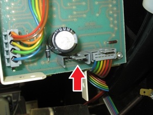

This connector is empty. Is this normal?

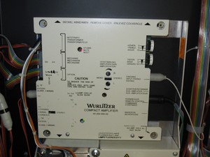

I did some homework and I believe it's the I-84 amp which was issued on older OMT models issued from 1988 to 1996. (Has treble and bass thumb controls)

You have posted some pretty nice photo's--of course they do not show the "important" parts---
Need to see the whole board that the connector is empty on, and the bottom right corner of the S&CC, which has a number on it--
The un-connected green plug in the center of the door is for a dollar bill unit--
And it appears as if the service switch ( could be marked "Gripper") on the mechanism board, is in the "off position"--needs to be "on".

3. Green plug, if I recall correctly is an optional coin switch connection--depends on which coin "rejector" is installed ( all colored wires above are coin switch-set-ups)
4. White plug is coin switch common--should be attached to the marked, "upsidedown T" post ( German for "ground", or maybe "chassis ground"--don't recall) Red is usually power--may connect to reds on door ?
BTW--get thee a pinball rubber for the door motors--works better then the originals--

Pinball rubber, either white, or black, about that diameter, is fine-will last much longer then original stuff, so I would buy no more then 2--
