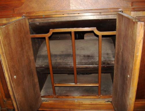

Re: Attn: Steve -- "Western Electric" horns
by Joe_DS » Sun Apr 11, 2010 7:37 pm
I thought I'd resurrect this old post string to add another photo. This one is the VV-4-40 horn--copied from a craigslist post--which followed the same fold pattern as the Credenza and its slightly smaller brother, the VV-8-4. While hard to tell in the photo, the bottom portion of the horn has a very gradual taper, and is not quite flat. The heart, which contains the conduit for the four sections, is quite large, talking over most of the space inside the chamber.
4-40 Horn--small.JPG (28.8 KiB) Viewed 7137 times
The mouth of the horn measures 16 1/2 inches high by 16 1/2 inches wide, while its overall length is about 4 3/4 feet, which means that it can reproduce the upper range of bass pretty well. Restored, and if the acoustic conditions are right, it provides a rich, room filling sound, slightly more mellow than the Credenza, but more powerful than the smaller (four-series) models such as the VV-4-3 or VV-4-7.
