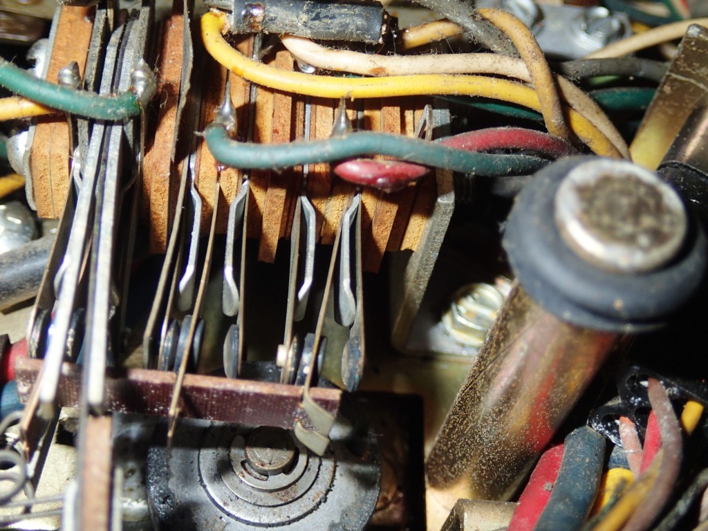

I have slid the mechanism right out and had a very close look at all the wires leading from the 110v plug at the head, the contacts are next in line and very close inspection showed that the contact coming down between IM7 and IM8 is definatley broken at the top as you suggested. I have removed it and the fuse now does not blow.
So my next job will be to make a new contact, to start with i will try to pinch a similar one from my old UDPU and make one, hope I can just loosen the screws and slide it in, clamping it in place by tightening the screws.

Glad you found it ! If not a center blade, with double sided contacts, you can "pinch one" and slide it in with a little patience.
I have done so, way too many times !! Be sure to check the inverted "V" adjustments, and set them to the minimal amount required to "flip" that switch. You might also check that the motor condenser "add" contact, is operating as it should. Ron Rich

I took a photo of the broken contact for others to see if they are looking for the same fault. As Ron says - look closely, from below if possible, as they all seem to work OK but you can see the contact broken at the top and is not "sprung" like the others but still straight and laying at an angle shorting both Live & Neutral contacts.
Kevin (ss160uk)
the right hand side centre blade is broken at the top
Broken contact Seeburg ss160 reversing switch.JPG (227.28 KiB) Viewed 1291 times
