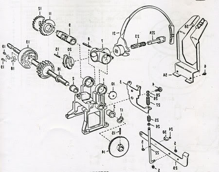

Can someone explain to me how the inner grabber works?
My grabber moves when you manually manipulate it, but does not seem to move as a function of the gears.
This is how it always looks on platter Image
and over the magazine
Re: Help with Rockola 1000
by Ron Rich » Tue Jan 24, 2012 7:03 pm
OK--remember that old saying--"a picture is worth a thousand words"--- well, I see your problem--
You are missing part of the gripper assembly. Check out your parts book, or look at the RockOla lubrication guide posted here somewhere, and you will see that you are missing at least one, if not two gears--

I saw a video of a rock-ola assembly where it appears that the turntable moves towards the gripper and this activates the inner gripper. I don't think this applies to my jukebox. I have a parts diagram, for this juke, and I didn't see any missing gears (but I will check again and perhaps scan). I had the same thought originally, but perhaps I am totally wrong. Will check.

by rockola1000 » Tue Jan 24, 2012 9:50 pm
rockola1000
Posts: 30
Joined: Sun Jan 15, 2012 4:19 pm
by rockola1000 » Tue Jan 24, 2012 11:42 pm
Ron, you are right again. My assembly is missing the top outer gear. I owe you a case of beer
