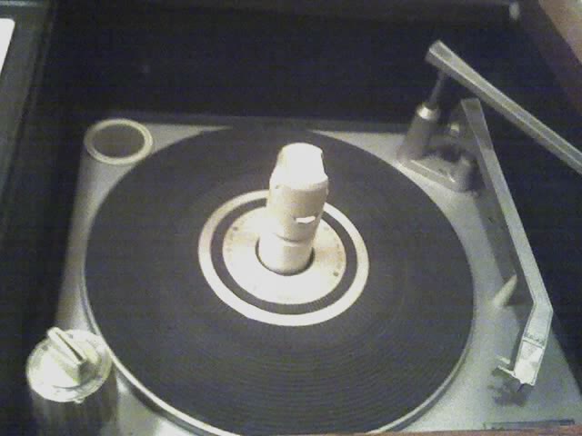

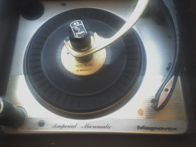

They are all so similar inspite of their cosmetic differences. I know the newer models have only one idler wheel for speed and record changing. I haven't investigated to see what series I actually have, but gotta love em anyway with the different models that I have. --BB
