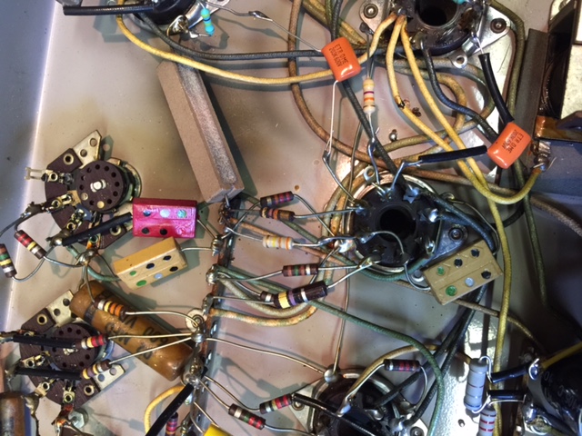

by Uptown » Wed Aug 12, 2015 7:59 pm
I have a model D hideaway that I wanted to resurrect, just for the fun of it. It's in decent shape so I pulled the amp and started recapping and replacing out of tolerance resistors. When I got to the 6SN7 closest to the output tubes it didn't match the schematic at all. Pin 3 has two resistors coming off of it to two separate wires from the transformer, I'm guessing that they are opposite ends of the same winding as there is little resistance between the wires. I'm not sure if this is factory but it's been like this for a very long time and I'm pretty sure it was working when removed from service as I purchased it from the owner of the restaurant that closed down years ago.
My particular amp is beige colored and most I have seen on the web are black.
Perhaps there was a difference?
Not sure how to proceed, any help, information or suggestions appreciated.
Mauro

Re: AMI Model DD Amplifier Wiring
by Rob-NYC » Thu Aug 13, 2015 1:37 am
Mauro, pin 3 is a cathode of the driver section of the driver-paraphase tube. Since it comes from the output tran it is feedback. Either they modded the ckt, or did their usual sloppy drawing. It looks original, I'd leave it.
by Uptown » Thu Aug 13, 2015 5:27 pm
Hi Rob,
I'm glad you replied.
I don't have enough electronic theory knowledge to understand how this circuit behaves but it looks like a mistake even if it's original. Does it make sense that both sides of a winding end up at the same pin through these 2 resistors?
I was hoping someone might have a similar amp and could look at it.
Anyway I have great confidence in all your answers and will take your advise and leave it, I guess I was just curious about how this feedback circuit worked as opposed to grounding one side of the winding as shown in the schematic.
Thanks for your input,
Mauro

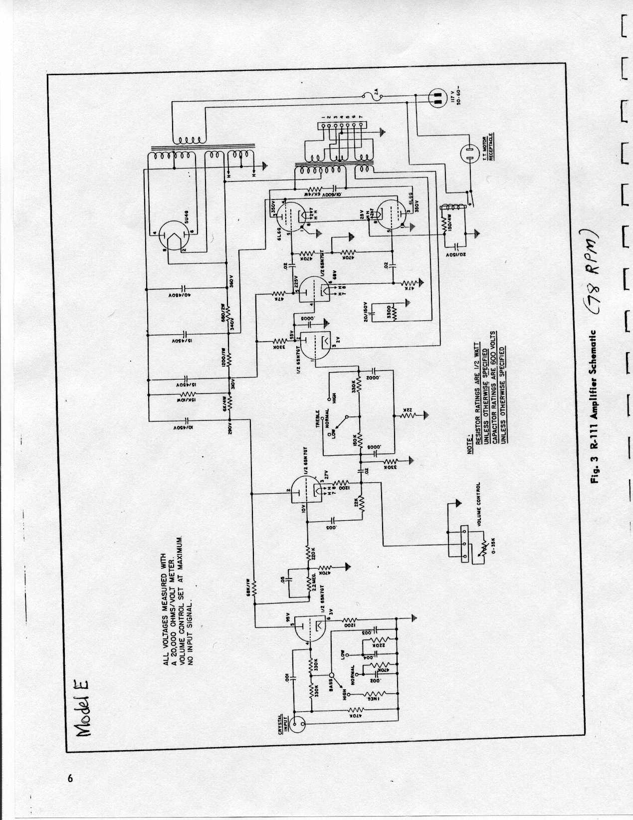

Re: AMI Model DD Amplifier Wiring -revised link
by Rob-NYC » Fri Aug 14, 2015 5:50 am
Mauro, take a look at the E (45rpm) amp:
http://www.verntisdale.com/schem/ami-ea.jpg
This makes more sense schematically and looks similar to what you have.
by MattTech » Fri Aug 14, 2015 6:22 am
Looks like a standard cathode bypass method with a bit of transformer-fed negative feedback to me.
by Uptown » Fri Aug 14, 2015 11:42 pm
Rob,
That's it!
Thank you for posting that, I feel much better about it now.
Probably a mid-production change that is not reflected on my schematic.
The "not knowing" would have bothered me to no end.
Back to work on this one now.
Many thanks,
Mauro

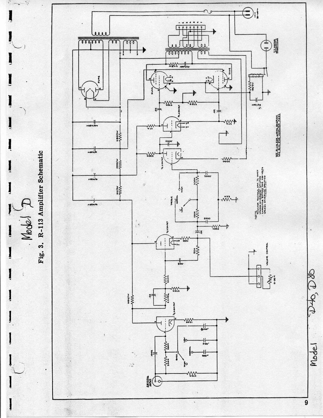

by Rob-NYC » Wed Dec 16, 2015 7:19 am
Carl, looking at these two schematics:
http://www.verntisdale.com/schem/ami-d.jpg:
http://www.verntisdale.com/schem/ami-e.jpg
You can see that the first stage cathode has no bypass cap. Adding one would give approx 6-7db of additional gain. Start with approx 22mfd -but any higher value would be OK since this is not in a feedback loop.
AMI designed these in to two configurations; one for 78s and the other for 45rpm. Since 45 need more gain than 78 (at least back in the early days of 45rpm), AMI simply added cathode bypass caps to make up the difference.
