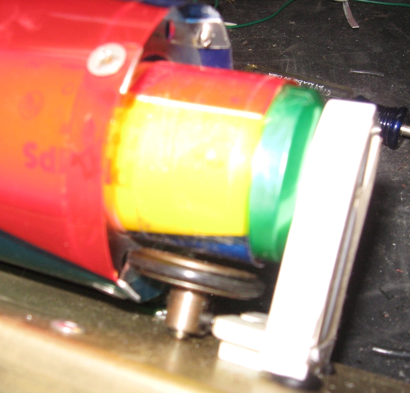

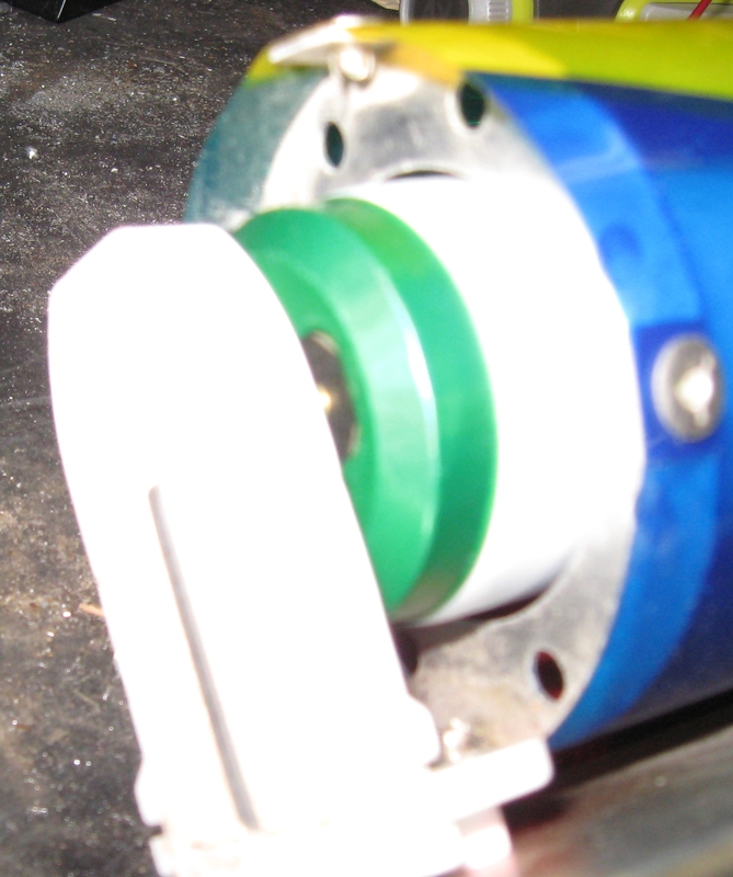

Know i am into the florescent lighting on this jukebox. I replaced both the ballast and starters for the front lights. They are working nice and bright know. The problem i am having is the rotating color cylinders. The motors run fine (looks like they have been replaced) . The problem is the cylinders will turn for awhile and stop but the motor is still turning. Is there a part missing here or what? Just seem weird that they would just flop around on the tube. I have one on my bench at this time. Real fun getting it out as someone screwed the bottom into the cabinet and they made a bracket to hold the top in and i have not gotten to the one behind the coin receiver . I did look in the manual as far as replacing the bulbs and i seen something about a pressing down on a spring. There are no springs anyplace. This is what make me suspicious that something might be missing.

Well i think this is something someone made up. I looked in all 4 manual that i have. They do not show any real parts description but do show a motor with a chain. I do have a motor but it it is not like that and i do not have a chain. Grabbing at straws here, Would it be possible that a different model used something like i have? I do see a set of these colored light sticks for sale on ebay but then i also see the metal parts for the ends and these do not even look like what i have. Looking like i am going to have to see if i can make them work. Damn i was hoping to have this done in time for Christmas. Looks like the grand kids are going to be disappointed

Re: Seeburg M100C
by Rob-NYC » Tue Dec 15, 2015 12:53 am
Stan, what you have is a packaged retrofit. The lampholders (tombstones) are new design that wasn't available back then.
If the color cylinders are stopping it is essential to determines whether they or the motor are actually stopped.
The ends of a fluorescent lamps are where the heaters (cathodes) are and the heat from those can deform a plastic sleeve causing it to jam
When they stop, crain your neck and see if the motor is still turning and how free the cylinders are. There seems to be a bit of gel sleeve that is fixed. Check that it isn't binding against either the motor pulley or cylinder.

Rob, Have both the units on my bench. Like i said a real PITA to get them out. In fact my neighbor came by and got the two other screws out ( behind the coin changer and at the bottom). This old man can,t do that stuff anymore. The motors do keep turning. It is the cylinders that jam. Very sloppy fit between the tube and the metal ring. Thinking of making a hard rubber gasket to keep the tube in position better. Not to tight but just right. This will also give the O ring a rubber contact not metal. Also going to make it so if these ever have to come out again it will require taking one bolt out. Thank for letting me know that they are a retrofit. To bad the other guy had no idea how to fit a retrofit.
