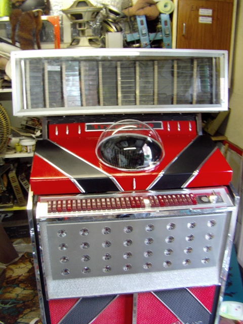

Hi everyone, just thought you might want to have a look at this Tropicana,

I know! I have committed sacrilege, but it was this or break it for parts.

A TropiContinental, or as my father used to call some of my mashups: FrankenJuke.
Seriously, it is distinctive and doesn't look bad. have you lit the mech compartment?

Yep the mech compartment is lit with a red glow, the scan switch assembly has a lovely cover on it made from a plastic meat dish, the lid with the dome is made from thick Perspex, heated and bent to shape. the title board compartment on the top is made out of scrap plywood and the top glass and frame from a seeburg showcase. it is curved at the back so I could fit the 10 title card holders in one row, otherwise would have had a very wide juke. To my surprise the wife likes it maybe it might be allowed in the house for a while when it is finished. Already been allowed four in the house one more won't make a lot of difference. Harry.

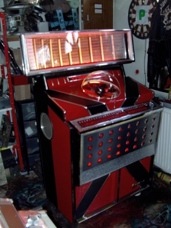

Well it's finished, apart from, the job I hate, typing out another 90 title cards. somebody out there might like it in their games room.
until then it's coming in the house. ps, the dam thing decided to stop selecting anything with the number two. hairline crack on the track for number two on search unit board, solder is a wonderful thing. Decided to remove the valve amps cos they are to good to be left in a frankenjuke, fitted a Teac ah 300 instead so it has turned into a music centre :twisted: connect Ipod cd player etc. and of course vinyl :roll:
