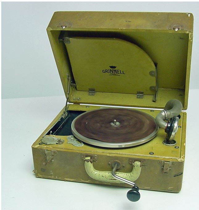

I just bought this suitcase portable on EBay:
[url]cgi.ebay.com/ws/eBayISAPI.dll?ViewItem&item=161031416871[/url]
Grinnell Brothers was a sales distributor, not a manufacturer. Can anybody tell me who the manufacturer most likely was, and when it was made? Someone on another forum suggested that it could be a Birch (Boetsch), but a search online did not turn up any particular model by this manufacturer that is the same as my phonograph.

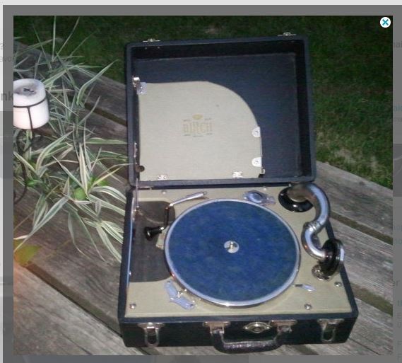

BUT, if you compare the one you have --
Green Portable.JPG (59.48 KiB) Viewed 1077 times
(CLICK ON IMAGE TO MAKE IT FULL SIZE FOR EASY VIEWING)
...with this Birch (branded) model featured on this page -- http://www.etsy.com/listing/105651805/v ... k-portable --
Birch Portable.JPG (56.85 KiB) Viewed 1077 times
...you'll see some similarities:
the same record storage container (normally a unique feature of portables)
the same tonearm
the same type of (open) horn
the crank hole is in the same position, relative to the turntable and spindle
the same type of speed control
the same type of handle, hinges, etc.
About the only differences I see involve the positions of the needle cup and brake, which often varied on the same models year by year.
I'd say there's a very definite likelihood--if not a complete certainty--that the one you have was made by Birch for Grinnel.
