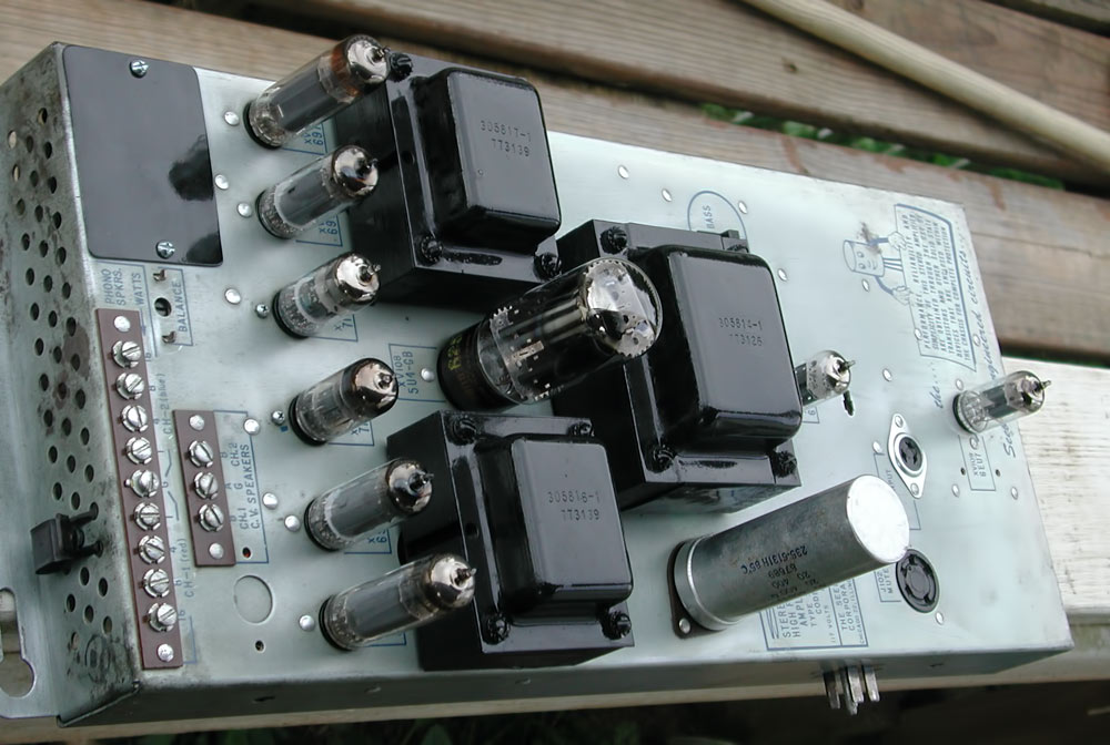

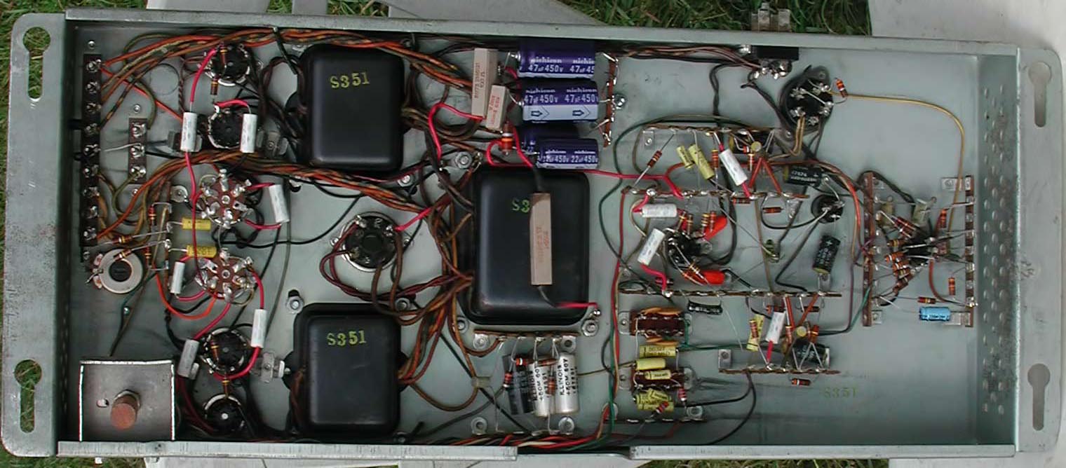

The amplifier had a couple problems. First problem was distortion. You could queue up a dozen songs and you were ready to shut it off after the last few songs because the electrical noise became annoying. Second problem was the bass and treble switches did nothing. Third problem was a loud "pop" when the mechanism trip solenoid fired. It was loud enough so that my wife sitting 20 feet away would jump.
The amp had a lot of dust/dirt accumulated inside, especially on the upward surfaces. I took the unit outside and sprayed the bottom side of the chassis, particularly the components with Soft Scrub bathroom cleaner and scrubbed it good with a toothbrush. Then I rinsed it off with a gentle targeted fine mist/spray of the garden hose... being extremely careful not to get water into the transformers. Not much rinsing water in those areas.
I knew it would be a few days until I got my parts, so I set the chassis under a 75watt light bulb. The bulb warmed the 3 transformers... Particularly the power transformer, keeping them very warm which evaporated any water left inside.
It is evident I'm the 3rd person who has replaced parts. Looks like the 1st person replaced most of the caps and did a good job. Leads strung through terminal holes, looped and soldered. Looks like a 2nd person replaced a couple caps and couldn't solder. One of those poor joints was found broken on an output transformer coupling cap, so only 1 side of the transformer could have been working. I bet that's part of the distortion.

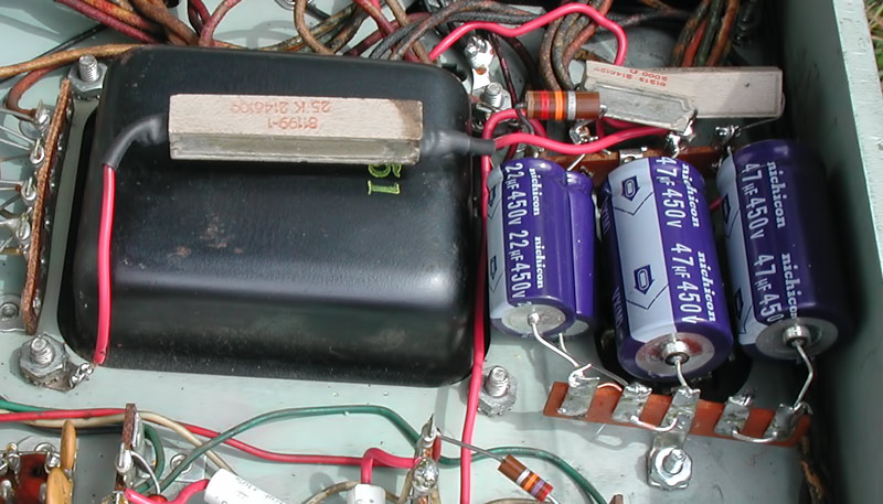

So I replaced all the coupling caps, plus the 200uf 6v on the AVC circuit along with the main power supply caps.
I did a bit of an error on the power supply caps. I originally put the resistors below the new caps and It looked really nice. Then I realized the resistors would heat up the electrolytic s so I had to flip it around and it looks a bit funky... Especially the resistor along the back side of the transformer. Oh well, it works.
In fact I am extremely pleased the way this has turned out. All the noticeable distortion has vanished, both tone switches work and the loud mech "pop" is gone. The sound of the phono was strong before, but more so now. I have the bass set to middle because it's boomy in the 20x30ft room if put on high. Mostly mid-range sound without much highs but I assume that's because of the singe pair of 12" speakers.

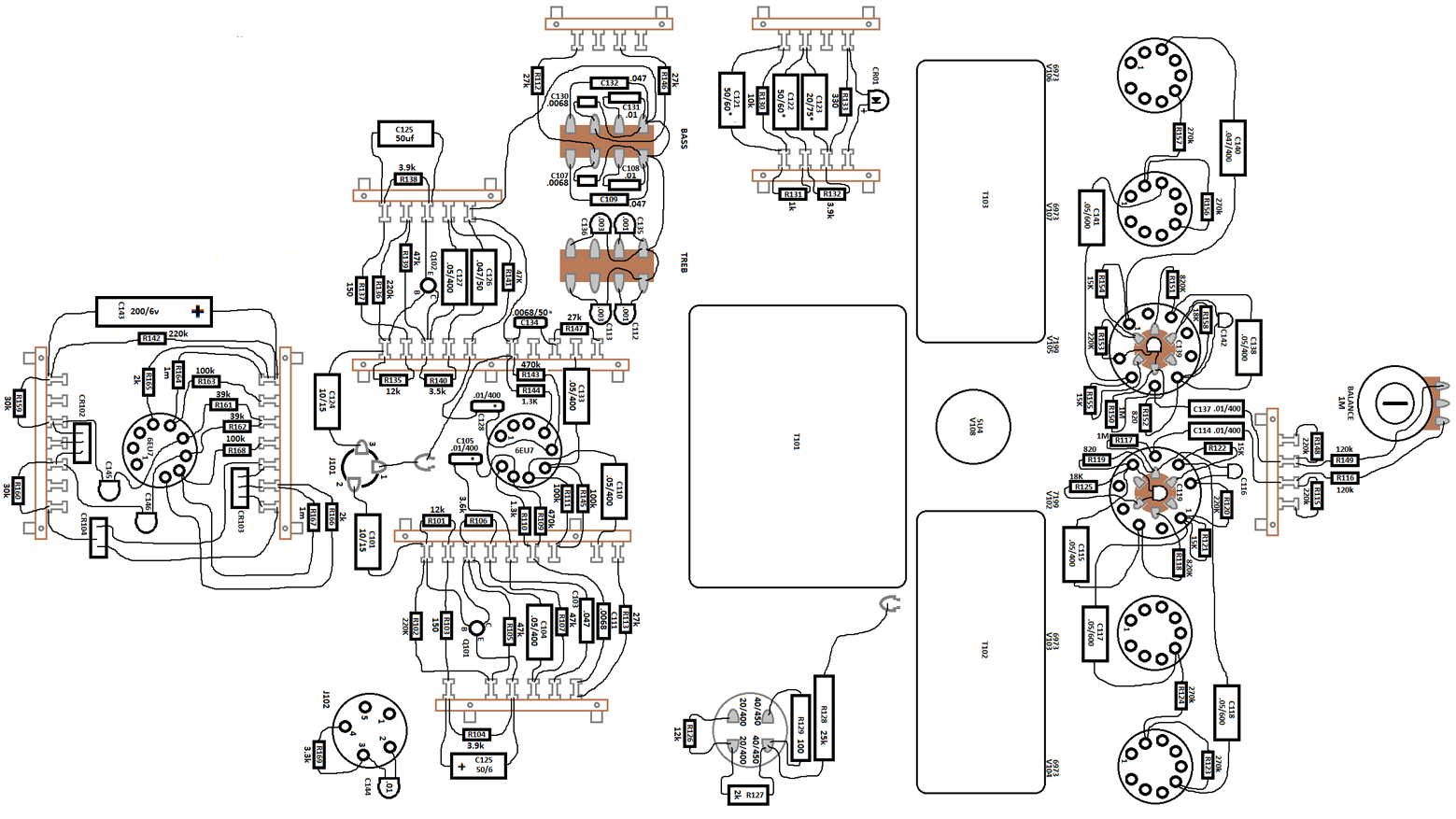

I took the time to map out the amp components. I've included it and maybe someone might find it helpful. I don't believe there to be any errors as it pertains to my particular amp.
Sorry for the larger files. I didn't want to loose resolution...

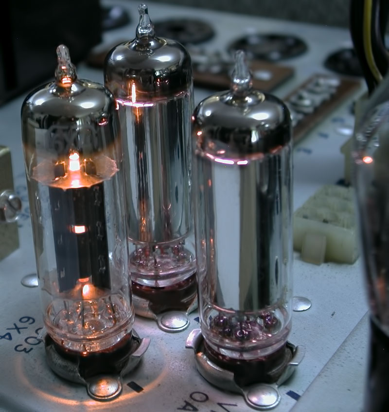

I snapped a couple photos of the Tormat Controller power supply tubes I thought was interesting:
Tubes!
More tubes!
Cool 0A2 regulator tube!
