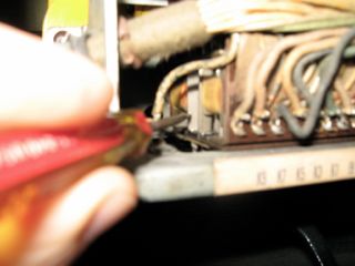

If I take the upper wooden panel off the back of the jukebox and select the K10 pin with my screw driver the mech will start to scan. once it reaches the pin while scanning the odd side it will actually hit the k10 pin in a little bit. Once the mech relays and starts scanning the evens it will miss the K10 pin because it was brushed against while it was finishing up the odd numbered side, with the pin in the halfway position but still engaged enough to make the mech scan it will cycle once more and then cancel the selection when the k10 pin is hit from the half way point all the way to the dormant position. Now… If i sneak a small flat head screw driver in between the two K pins holding the K10 Pin in the play position and let the mech scan, it will scan by it make a noise as it is completing the odd number scan then relay to the even numbers and make the selection (but only if I keep my screw driver against the pin through the whole sequence). Under neath on that contact block there are spring loaded cone shaped metal pieces and something tells me that one is hitting the k 10 pin incorrectly.
Is the contact block out of alignment ?
Look forward to hearing what your thoughts are.

Re: Seeburg pin bank trouble shooting
by Ron Rich » Sat Feb 07, 2015 7:59 pm
Hi Don,
It sounds to me like either the pin has been installed "backwards", all of the segments are miss-aligned ( very hard to do !), or something is wrong with the "dresser" in the frog. It's rather simple to determine--watch the white "sensor's" alignment to a selected pin. Ron Rich

Last time I was inside the pin bank was when I was 8 years old with my father at the helm. Vividly remember it to this day. The frog which I gather is the two white plastic headed metal pieces on the contact block. They both look fine. No signs of wear. The pin that is giving me trouble will not go directly over the frog, it brushed to the side of it when it should go directly over. I think you're on to something with the magnets.
by Ron Rich » Thu Feb 12, 2015 7:27 pm
Hi Don,
If just one pin is being "knocked aside", by the dresser, and the sensor is not contacting it, it is possible it is just "bent"--If installed correctly, you can "re-form it", without the need to remove it, by CAREFULLY/gently, bending it-- Ron Rich
