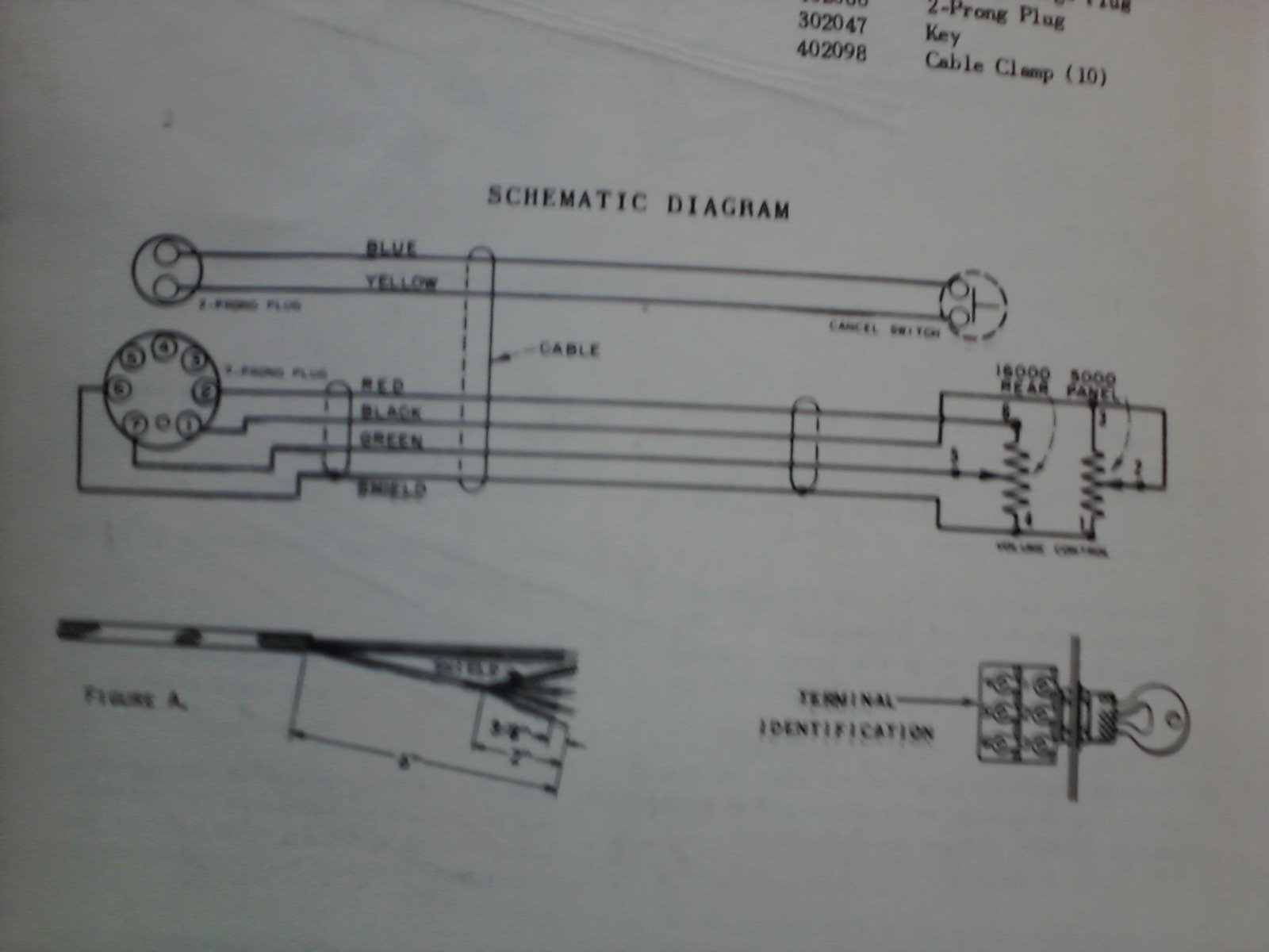

I have found a double gang POT that I have added resistors to so that it is close (5K and 16K) to what the specification is for a M100A Seeburg remote. The problem is that I have no idea if the six contacts are in the same "pattern" as the original. See the attached photo of the page in the manual. The problem is that the contacts are labeled one through six on the POT and the PLUG. I followed the same pattern via the color code, but that may just a guess.
What I want to know is that if anyone has a remote volume control... can you take a VOM and measure the resistance at each plug end with the POT at 12 o'clock and then say at 10 O'clock. That way I should be able to wire the plug correctly and do something that will harm the amp when I pug it in.
Thanks, James

Obviously, I got something wrong. What I did was to put a resistor in parallel with each pot element until each measures 5K and 16K respectively.
However, something is not working correct and I am getting full volume.
With the POT at 12 O'clock I get:
Shield to Green at 5K
Shield to Red at 5K
Shield to Black at 16.62K
With the POT at 10 O'clock I get:
Shield to Green at 3.4
Shield to Red at 48.36K
Shield to Black at 15.61K
What I have wrong is beyond me. In addition to this little problem...I need to get my Seeburg AP-1 down to you. I think I will dump both of these in your lap...unless you want to make a trip up to The City again.

Do you have page 8005 and 8006 in your Service Manual ? That shows the RVC wiring, which should work with any "case"--and the Tisdale supplied VC.

Well, I think I have an idea what is up. I pulled the rear panel off the box and traced the volume wires to the plug.
Assuming the shaft is to the right and one is looking down onto the POTS...
The 4 wires on the Dual gang POT run as follows:
#1 (front POT) jumps to #4 (rear POT) then runs with a black wire to ground then Pin #6
#2 (front POT) jumps to #3 (front POT) and ALSO runs (Light Gray) to Pin #4
#3 (Front POT) jumps to #2 (front POT)
#4 (rear POT) jumps to #1 (front POT) and (black) goes to a ground and Pin #6
#5 (rear POT) runs (Tan with tracer) to Pin #5
#6 (rear POT) runs (brown) to Pin #3
There is the problem. In the schematic on the last page (152) of the manual I have they show pins 1,2,6, and 7 as being used on the MRVC-1. Also, those were the pins with cut wires on the plug I got from Bill up in Napa.
So the questions is, which one to have faith in? I suspect that I should just duplicate what the main volume control on the box does and ignore the schematic in the book.
Thoughts?
James

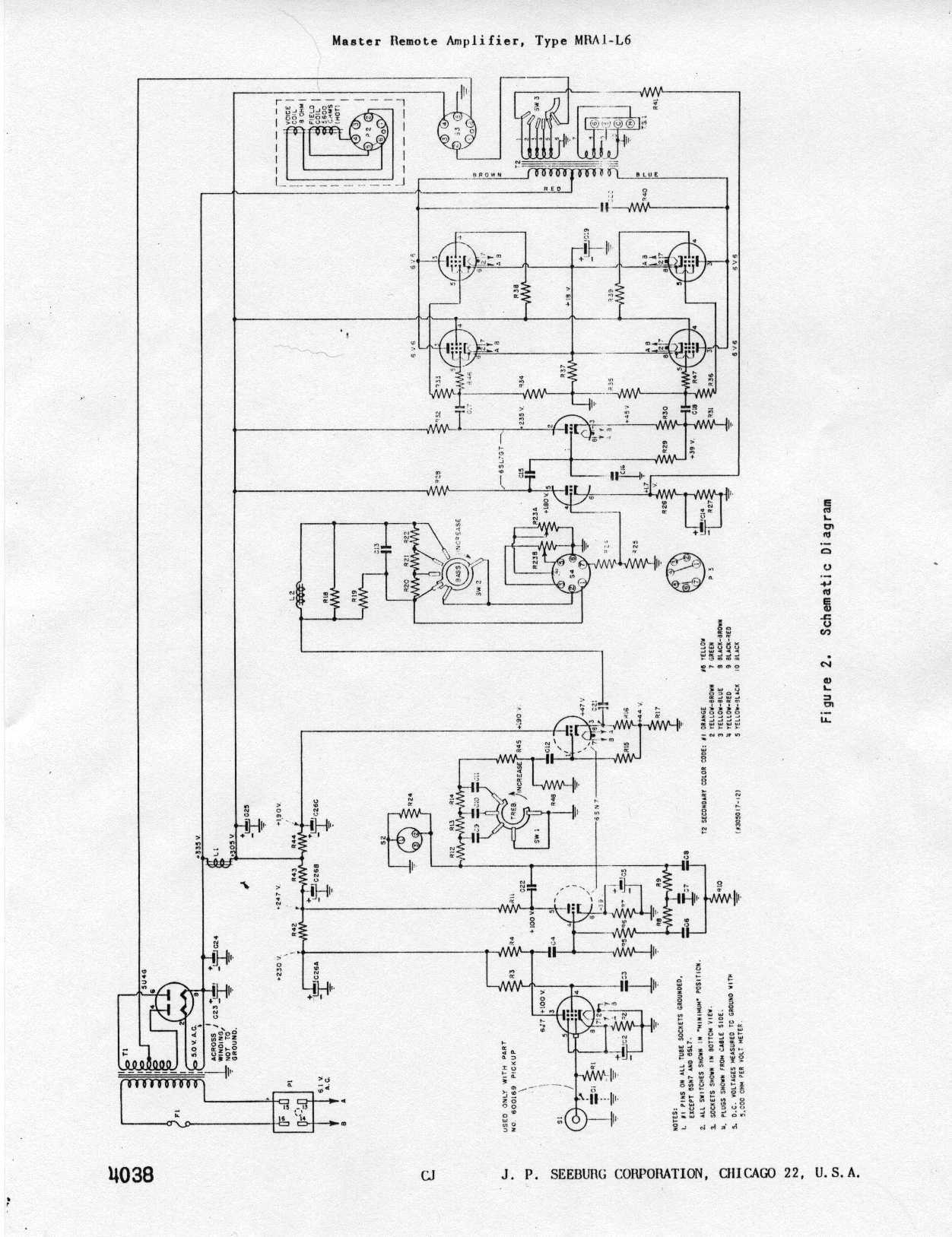

by Rob-NYC » Tue Jul 29, 2014 8:30 am
James, based on this schematic: http://www.verntisdale.com/schem/mra1-l6.jpg -and your photo, I suggest this wiring:
Looking at the pot as pictured, the top two sets of lugs, one on each section: Ground connect to Pin 6 RVC plug. --Make sure this is connected properly or you will get full volume w/no control.
The center lugs are the arm (wipers). Arm of the 16K-Ohm pot goes to Pin 7. Arm of the 6K-Ohm pot strapped to the high side lug and both to Pin 1.
High side (bottom lugs in your pic): 16K-Ohm pot to Pin 2.
There should be NO connection to the internal volume pot when RVC is in-use.

As Rob mentioned--there should be zero connections to the internal volume control, when using a "remote". One of Rob's
"Geppeto friends" must have been "playing around" and hard wired it to the socket--See the schematic for correct socket wiring.
The whole purpose of the "dummy plug" -SOCKET- design is to connect either, an internal, or external, volume control to the amp., quickly, by "changing the plug". Ron Rich

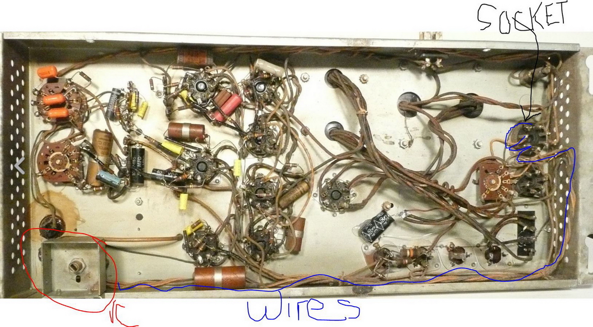

I am going to be gone all day...I will post photos of everything tomorrow. The on-board volume control, wiring, and socket is all dead stock. Shows no signs of any work ever done. I suspect that the manual wiring for the remote is correct. That the remote plug uses the other pins and thus "isolates" the original" on-board control. There is probably some other combination that I somehow missing...

I would bet my "bippy", if I had one, that the wiring is NOT original to that amp !
I have worked on too many of them, and never seen a socket "hard wired" to the VC---
That would defeat the purpose of having a socket-- Seeburg would never have installed it, if they could have just hardwired the VC into the circuit. Ron Rich

Got back early. I just pulled the attached photo of ebay. Same AMP. You can see the volume control ,the 4 wires running from it , and the 4 wires terminate and are soldered to a socket. The other side of that socket has the dummy plug or the remote volume plug which can be plugged into it.
I suspect we are talking about 2 different things and/or I have screwed up on my descriptions.
James
