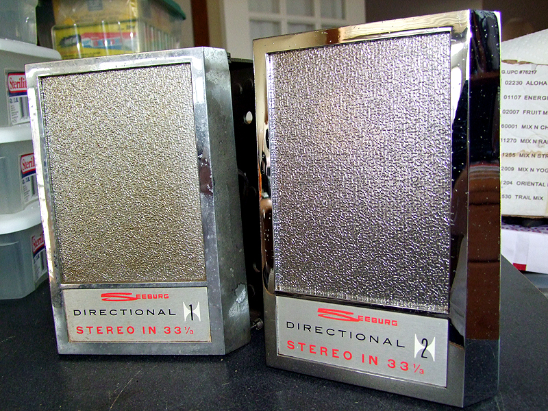

Okay, found a pair of working Ear Speakers... pretty good price on them as well. I am going on a raid this weekend for 45's, wall boxes, and some Juke parts.

by Dewman » Sun Apr 08, 2012 7:47 pm
Cleaning my ears...lol
One down, one to go!

I actually took them apart, so that I am only cleaning the grill, then I clean the plastic back, all separated from the speaker itself.
It is a germaphobe thing... just easier to pull everything apart to clean so that I know it is clean... wait until I really clean the juke... piece by piece...lol

by Dewman » Sun Apr 08, 2012 8:59 pm
Actually already done!
These things took me the better part of a day to get right, still need one part, (rca jack) on one, wire is there, but no jack.
This means the juke is going to take me the better part of 6 months to get clean and running at best...lol

If I may ask, where were fortunate enough to locate the ear speakers?
Thank you
Darrell

by Dewman » Tue Apr 10, 2012 6:49 pm
ds100h wrote:If I may ask, where were fortunate enough to locate the ear speakers?
Darrell,
I was able (through a couple of friends) track down an old Juke-op/juke repair guy about 60 miles from me. I lucked out and he had a pair, they were dirty and needed a new plug, but I tested both speakers and they worked... they weren't cheap.
I can see if he has another pair... though I am not sure what shape they would be in, and what he would want. Or I can even see if I can pass his info on to you?
He is out of the business, so it took about 12 emails with his son before I could even get his number... but hey, never hurts to ask right?
Just let me know,
Andy

Welcome to the board. You were very fortunate. I passed on buying a few nice Juke Boxes because I was unable to locate any ear speakers for sale! Did you put new caps in the ear. Speakers and if so who did you buy the caps from?

I replaced the caps, but didn't have to buy them as they were given to me with the speakers... the juke doesnt work, but I connected them to the "audio out" on a set top DVD player and they played great... sounded better than I thought!
