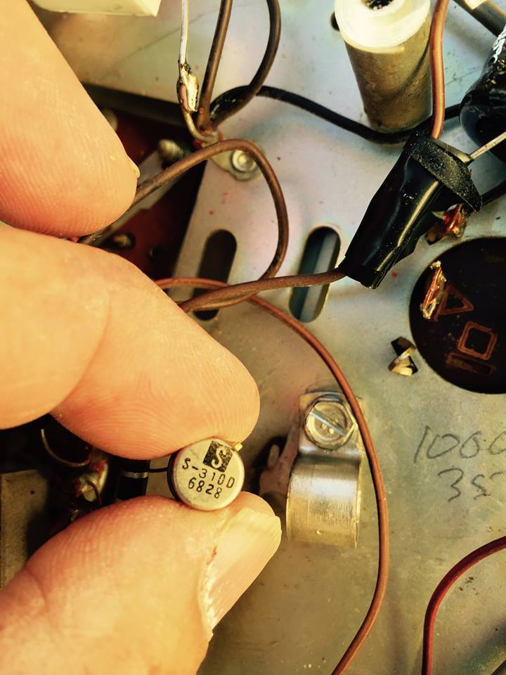

Source for this transistor
eddie
Posts: 118
Location: Sharon SC USA
by eddie » Wed May 13, 2015 5:17 pm
Or a cross reference
Re: Source for this transistor
by Ron Rich » Wed May 13, 2015 5:20 pm
Ed,
What's it used in ?? Didja look it up in the NTE book ?
eddie
Posts: 118
by eddie » Wed May 13, 2015 7:22 pm
AMI MM2
by Rob-NYC » Thu May 14, 2015 3:01 pm
Eddie, if you are still around, that is just an NPN in a TO-5 case with a insulation sleeve. Used both there are v-reg for the preamp card and as a pre-driver on the driver boards (Q-72). When I got two of those amps for commercial service in 1990 that reg was open in one, I just used an NPN power tab (TO-220) booted the tab w/PVC, and used heatsink compound and placed it under the clamp. The power transistor was so overrated for the purposed that it really didn't need any sinking.

eddie
Posts: 118
by eddie » Thu May 14, 2015 3:35 pm
by Rob-NYC » Thu May 14, 2015 4:27 pm
Eddie, you don't need a compound for this sort of thing. Just a simple NPN will do:
http://www.onsemi.com/pub_link/Collateral/BD135-D.PDF
Just make sure the collector -emitter voltage is above the B+. In this case the BD139G would be in the ballpark If you have a Radio shack open nearby, they may still have what i used.
Check the 24Volt Zener too.
