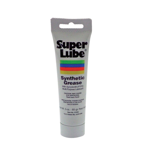

by MattTech » Thu Nov 12, 2015 3:40 am
Best lube on the planet - never "freezes" never dries out.
