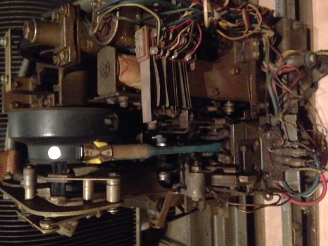

Who can advise how, and with what to wash / clean the SMC1 mechanism ?
I inherited an SMC1 from my father, which was in his possession for 30 years. All this period it stood in a smoke infested place, without ever being serviced. Miraculously it still worked, being in this condition. Though sometimes took wrong selections. And if sled came from left side it could only play a sides, and coming from the right only b sides....
I plan to buy the new MCU from Ron, and also his repair guide after the holidays . And of course all needed spares. ( motor coupling is also twisted ...)
Now I only have the parts catalogue.
But I would like to start cleaning it already.
Can the mech being cleaned / washed without taking it apart completely ? Only taking of the electric parts ?
All other tips and tricks are welcome of course also.

Hi Kenneth,
That sure does not look "dirty" to me !! :lol: I have seen much "dirtier" Seeburg mechanisms-- :wink:
Since you plan to purchase the "Seeburg Mechanism Guide", I strongly suggest that you do so, PRIOR to washing it, as I have described how I do it in the guide. PM me, or contact me at: ronnnrich@yahoo.com when you want to purchase the items--
Your "side playing" problem could be either in the MCU, or the Inter Face Board (IFB) in the Phono Control Center (PCC).
