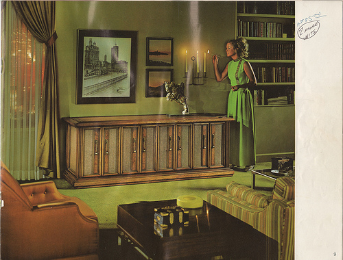

Here is my console
70Mag 9 by jsanford_rambler, on Flickr
