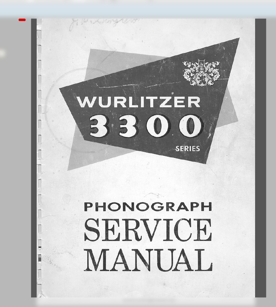

Should I lubricate this mechanism? The rod that makes the clamp come out ? It says in the manual not to oil the turntable drive's bearing, but is there a way to oil something to help with the Clamp's forward and grabbing movement without having to undo anything? The whole Juke does not look like it had much love in 30+ years... I will try to undo that with your site's help!

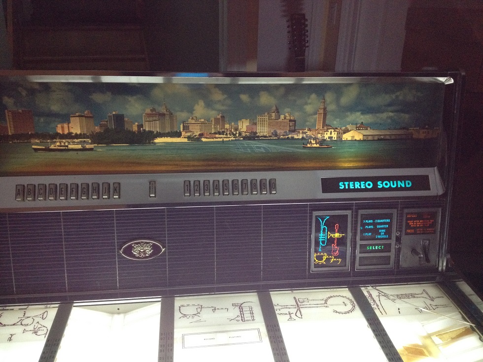

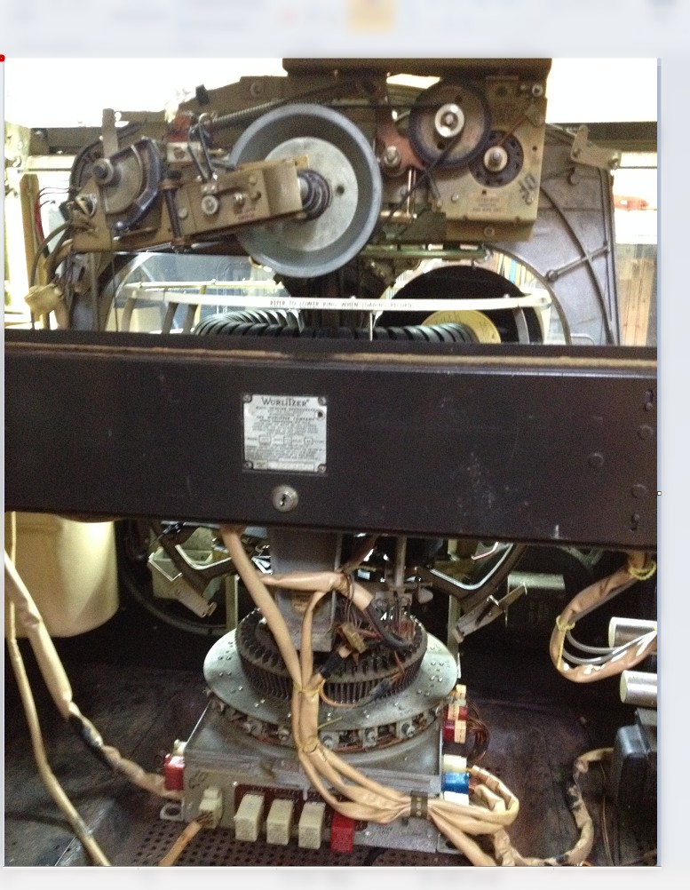

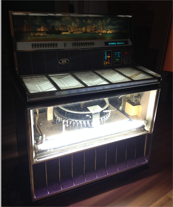

Joining a pic of the manual I am using And pics of the jukebox

View of the Bezel
This is the manual I am using
Wurlitzer_Model_3300_Americana_III_1968-69L.pdf - Adobe Reader.jpg (173.47 KiB) Viewed 448 times

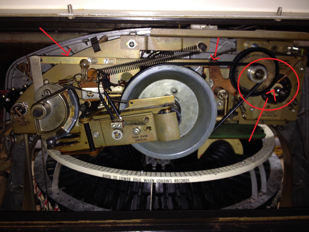

by Ron Rich » Wed Feb 03, 2016 2:45 am
Julie,
Unfortunately, I can't determine anything from those vids--hopefully someone else can--but you should not push, nor force, anything such as the idler wheel--SOMETHING is "locking it up", and it must be found-- I suspect a cam arm follower, has been bent somehow-- Ron Rich

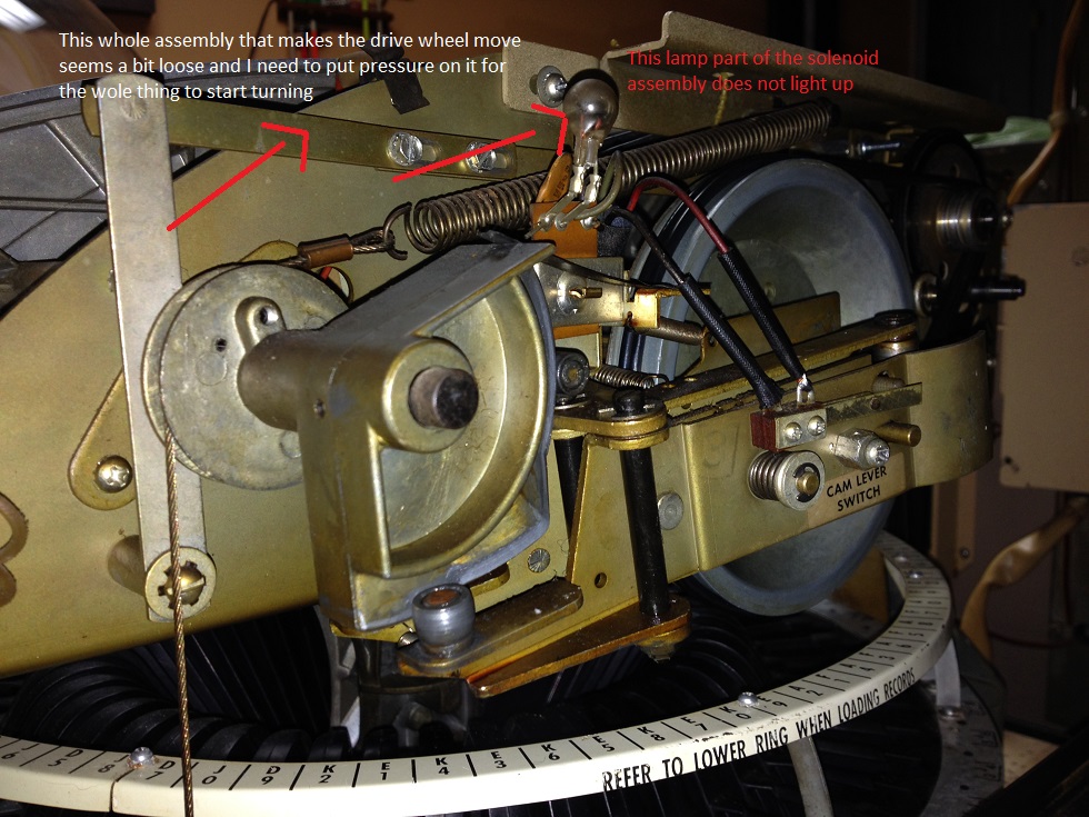

by 0070julie » Wed Feb 03, 2016 3:36 am
Ok Ron, I will look up the cam arm in the manual. Also I see that I have a 33rpm adapter on the clamp that I did not see in other Wurlitzer videos. Is there a 33 rpm setting on these machines?
I am also wondering what the burned lamp on the solenoid assembly is for..
I will continue looking thanks a lot for your help Ron!
